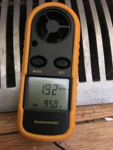

    Pic 1 - floor register with Harman on low flame!

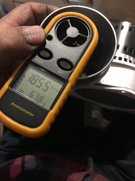

    Pic 2 - brand new Englander 85 CFM Exhaust Blower on Venting flange for a baseline to compare an old or dirty stove!
    Baseline Feet per Minute measured here is approx 1855 ft/min

    Not sure. Seems like you're mixing metric and standard units. Is there a conversion factor between square meters and square feet figured in there? 1 inch is 2.54 cm.
    It seems like you'd want to use pipe radius? 1.5 inch radius for 3 inch pipe? Some of the blower output is bypassing the fan in the meter.
    1.5 inch/12 = 0.125 ft.
    0.125 x 0.125 x π = 0.049 ft^2
    0.049 ft^2 x 1855 ft/min = 91 ft^3/min

    I think the air that passes thru the meter must be used in the calculations but a larger meter with a 3 inch diameter fan would be ideal.
    However, I am just trying to get a baseline for the 85 CFM Exhaust Blowers and if that is in just in wind speed like 1855 ft / min that is just fine. So I can test older stoves and they do not measure up then I can suggest replacement. I also found that the stronger 1.75 amp Motors with the tall blades measure 2250 ft / min so it gives me some numbers to compare with!!

    Thanks Bob - I like your explanation of the way they spec the motors with a large test adapter right at the motor and the fact that since I am taking the measurement on a small 3” exhaust flange with the motor in the Exhaust Housing will increase the wind speed and give the higher than rated spec of 85 CFM.
    That shows the calculations are in the right Ball Park! Thank-you!!!
