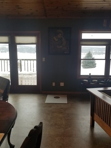

    Greeting FHC DIY'rs,
    I am contemplating my own installion of a stovepipe on a raised ridge steel roof. 6/12 pitch, 3 feet in from the soffet edge, cathedral ceiling. What do I need to know to do this myself or to be on my game if I opt for an installer to complete the task? I've never worked with a steel roof. Stove template is on the floor. When I get this figured out, I will have list of questions regarding stove selection. I am currently considering the Pacific Energy Alderlea T5 Classic.

    The easiest thing to do is get metal roof flashing for it. Excel and ventis both have them and they come with instructions. I usually cut in regular flashing but it is a bit more complicated
