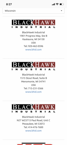

  8. Eric Wanderweg
    6,303
    47,738
    I started seeing Shars brand around maybe 10 years ago and laughed at them for being imported junk (on top of the name reminding me of SARS) A buddy of mine even bought one of their dial indicators for laughs. Wouldn’t you know it, 10 years later he’s still using his “junk” indicator every day and it’s still accurate if you check it against gage blocks. Might as well check Shars out since they’re close by. If you can get the results you’re looking for with a more “economical” chuck, why not?

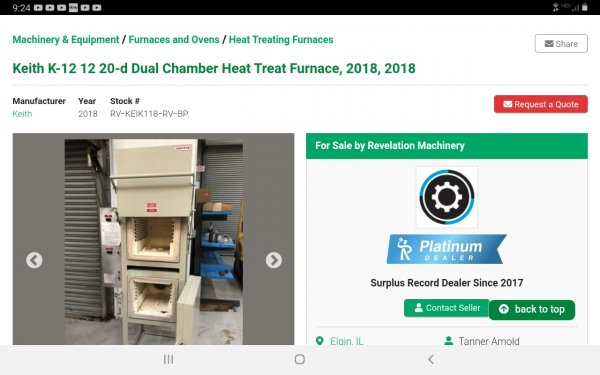

  14. Screwloose
    Screwloose
    Jan 15, 2017
    4,749
    27,161
    Thanks for the link !! Chuck didn't pan out but I have a call in for this ! Screenshot_20211014-092413_Chrome.jpg
  15. Eric Wanderweg
    6,303
    47,738
    That looks like a nice furnace! You could do your heat treating in the upper chamber while you're annealing in the lower one, if you've got a high volume of parts to do. Or you could do what I do and heat up your lunch in it :cool:
  16. Screwloose
    Screwloose
    Jan 15, 2017
    4,749
    27,161
    It's just want one for hobby use making tools ect. I bought a couple of tons (literally) of assorted virgin tool steel. A1, d2, o1, m2,s7 ect. from a closed electrical connector stamping company for less than $300.
    I have a Johnson programmable natural gas furnace with fire eye. Like new, bought from a school for fifty bucks ! Problem is that it takes a while to get down to annealing temps.
    The one I posted isn't happening as its $14500..... jeez it probably went for a grand or 2 at auction.
