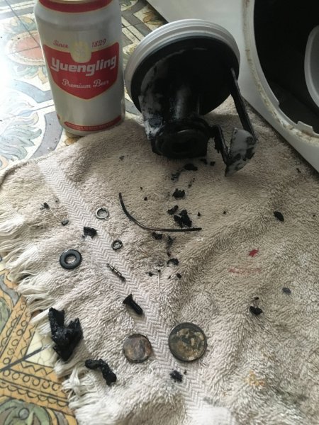

  11. PA Mountain Man
    PA Mountain Man
    Dec 17, 2020
    707
    4,271
    Lisburn, PA
    What things don't belong in this picture?
    Thanks Meche_03
    I owe ya :coldone:
    M2theB, Chaz, Loon and 6 others like this.
  12. Bret Hart
    Bret Hart
    1,058
    3,800
    Central NY
    Everything belongs except the swivel. That should be in the tackle box.
    M2theB, Chaz, mat60 and 1 other person like this.
  13. brenndatomu
    20,532
    127,912
    Your pocket contents? :whistle: :rofl: :lol:
    M2theB, Chaz, JackHammer and 4 others like this.
  14. Canadian border VT
    16,856
    109,143
    Glad You figured out which part needed to be fixed!:eek:
    I think I have same washer
    M2theB, Chaz, mat60 and 2 others like this.
  15. PA Mountain Man
    PA Mountain Man
    Dec 17, 2020
    707
    4,271
    Lisburn, PA
    Don't go countin your rounds.:picard:
    We're not outta this yet.
    Pump checks out.
    Still have same problem.
    I figured out to get the E01 code you have to let it try to verify locked door 3 times.
  16. buzz-saw
    buzz-saw
    Jan 31, 2020
    4,015
    23,008
    Ct.
    Looks like you just took a trip to the local hardware store.
    Ummm... let me guess that is the wifes lockwasher ( or 2 ) swivel and other assorted hardware. That loose change must be yours.
    Amazing that all that can get that far through the system and not get stuck in the drum.
    Good luck with the repair.
    Chaz, mat60, Horkn and 2 others like this.
