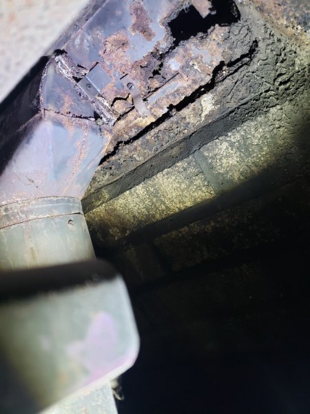

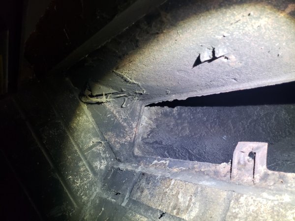

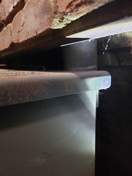

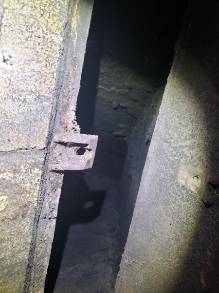

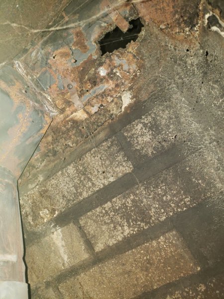

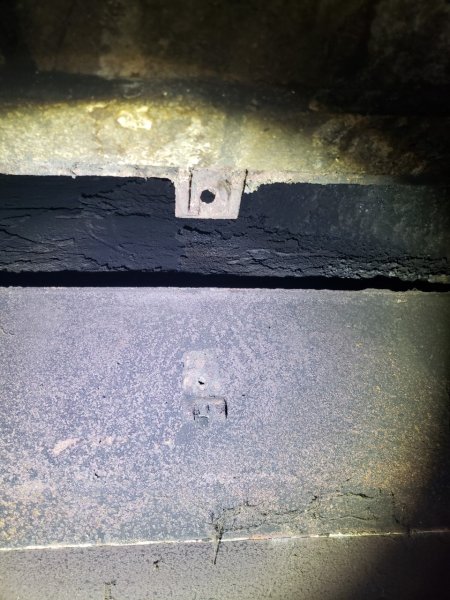

    Hello, I attached an image of a piece I need to replace. I'm unsure what it is called but that hole is freezing out my basement. If more images of the setup are needed just let me know. Thanks in advanced. 20200301_181114.jpg

  2. brenndatomu
    20,554
    128,074
    Need pics from further back...can't tell what we are even looking at...

  3. TJMas
    TJMas
    Mar 22, 2020
    11
    11

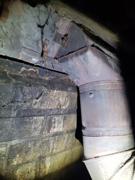

    thumbnail_20200322_134041.jpg thumbnail_20200322_134049.jpg thumbnail_20200322_134156_001.jpg
    It's where the back of the stove shoots up and attaches to the chimney opening.

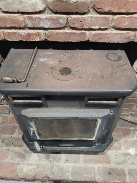

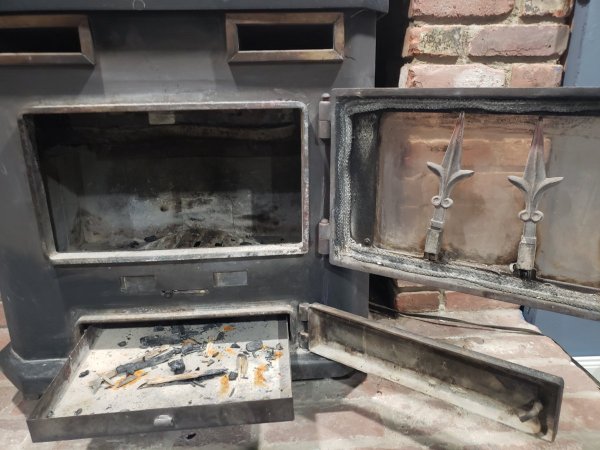

    20200301_180810.jpg 20200301_180834.jpg 20200301_180854.jpg 20200301_181006.jpg
    It was like this when I moved in back in August. It definitely needs a tune up, but that was the first major thing about it that I noticed. Here's the rest of it if you see anything else I should swap out.

  6. BHoller
    BHoller
    Jan 30, 2018
    318
    735
    Central pa
    The grate is shot. The glass has a bunch of furnace cement on it indicating a problem there. And the stove is pretty old. If it was me I would probably be looking for a new stove.

  7. brenndatomu
    20,554
    128,074
    This ^ ^ ^
    The stove looks like it may need some TLC too...hard to tell for sure from pics.
    If you are just trying to block the cold air from coming in for now, I would just stuff some insulation in the hole...that's assuming that the stove doesn't get used.
  8. TJMas
    TJMas
    Mar 22, 2020
    11
    11
    I took off whatever parts would come off, the roping needs to be replaced but that's easy enough, the wiring to the blower needs to be redone it completely snapped off when I moved the cable, the rest of it is solid, I'd like to use it, but the last fire I had going in there ended up smoking out the entire basement, I'm assuming from that hole in the block off plate and there was some leaking out from the bottom right side of the glass in the door. Fun little house project.

  10. TJMas
    TJMas
    Mar 22, 2020
    11
    11
    The furnace cement just crumbled off when I put it on a table so I think that might have been the issue, didn't have a solid seal on it anymore. You wouldn't happen to know what kind of liner I should get for this?

  14. TJMas
    TJMas
    Mar 22, 2020
    11
    11
    It is a 6" outlet. So basically just get a liner and shoot it down the chimney then hook it up to the back, like a dryer vent? I also noticed some kind of insulation between the inside of the metal frame and the glass window. Is there something specific I need or can I take some of the left over roping and shave it down to fit? Should the front not have cement like that? I bought some to replace it with, but if it isn't supposed to be there at all I try and find a manual or some original pictures.

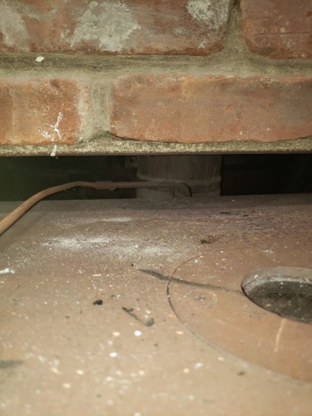

  20. TJMas
    TJMas
    Mar 22, 2020
    11
    11

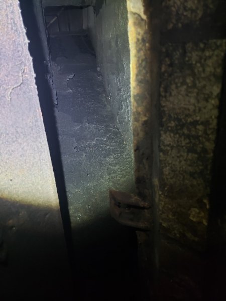

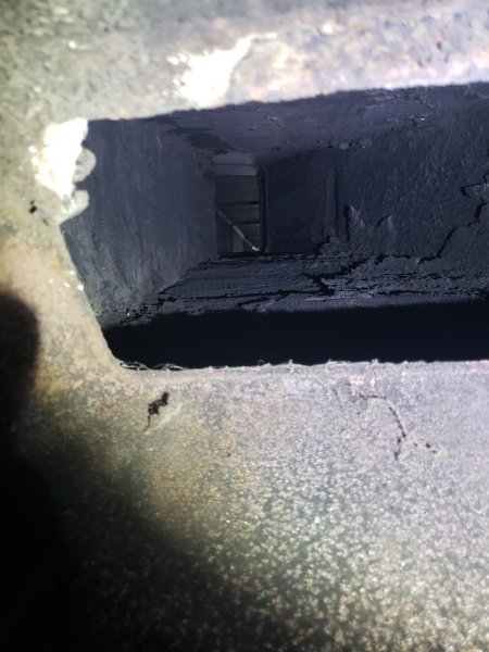

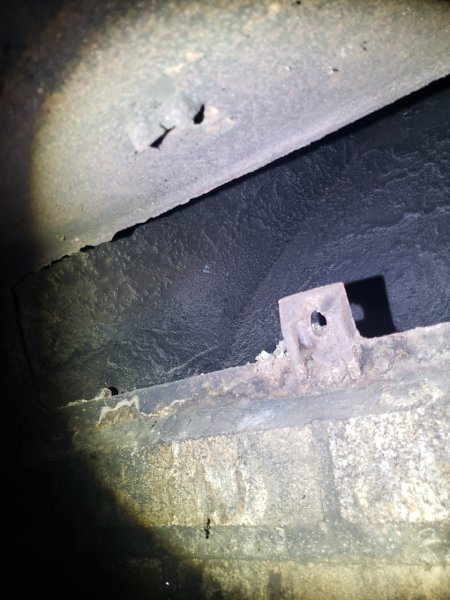

    So the opening there is 4x27 ish where the metal sticks out and 5x27 ish on the rest. thumbnail_20200323_124415.jpg thumbnail_20200323_124431.jpg thumbnail_20200323_124447.jpg thumbnail_20200323_124635.jpg thumbnail_20200323_124644.jpg thumbnail_20200323_124740.jpg thumbnail_20200323_124415.jpg thumbnail_20200323_124431.jpg thumbnail_20200323_124447.jpg thumbnail_20200323_124635.jpg thumbnail_20200323_124644.jpg thumbnail_20200323_124740.jpg
