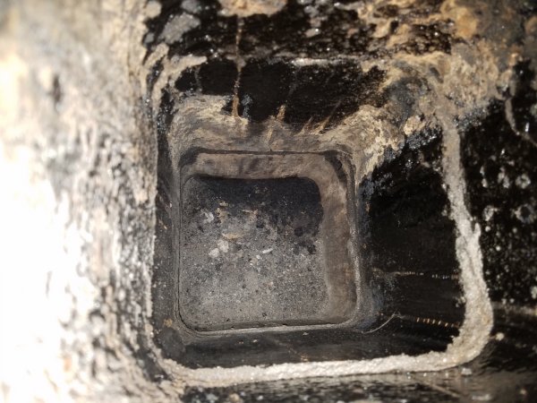

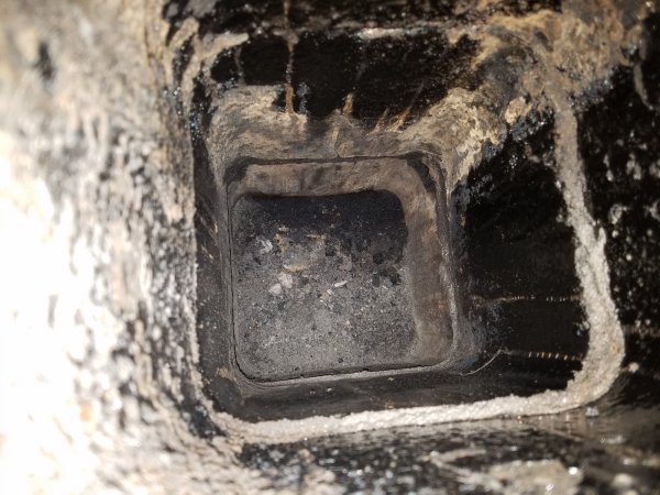

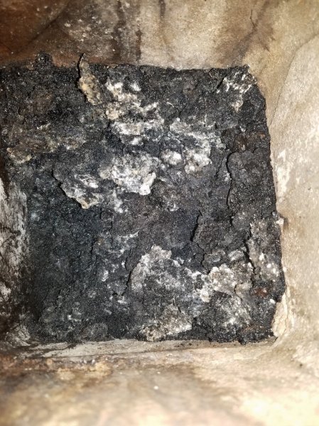

    A little background.....I bought a used osburn 2200 a few weeks back and plan to put it in myself sometime this summer. Currently I have a masonry chimney with a 7" square clay liner. I plan to put a 6" stainless liner in for the new stove. I was up this evening measuring everything and discovered that I couldn't get my tape to the bottom of the flue. Upon further inspection I discovered what looks to be a plug of creosote between where the flue comes out of the wall and the clean out at the bottom of the chimney. Any ideas on how to solve this? I was thinking of getting a long rod or something to try to chip a hole through it.
    Top 2 pics are from the crock looking down. Last pic is from the clean out looking up.

    The top 2 pics are from me sticking the camera through the wall and pointing down towards the clean out.
    The last pic was with the camera in the clean out pointing up to the top of the chimney.
  6. brenndatomu
    20,557
    128,088
    So it would seem like you can go in through the crock with a tool of some sort to break it up...get it to fall out the cleanout?

    That is a possibility. It looks like it's a bit below the crock so I have to reach a bit.
    Horkn, Flatlander Pete and Eric VW like this.
  9. brenndatomu
    20,557
    128,088
    Maybe drop a poker on a rope down the chimney, then reach in through the crock to operate it...once you get the first hole through I bet the whole thing falls apart pretty easily

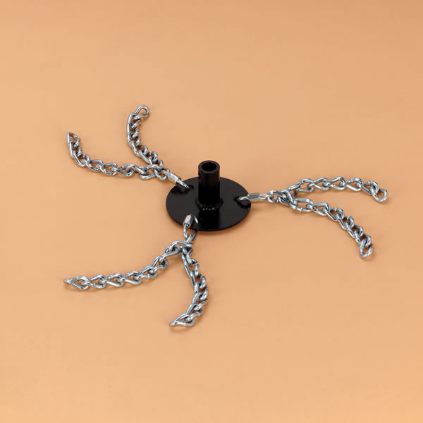

    After a miserable fail by a local chimney sweep service, we got lucky and borrowed a tool from a friend in Colorado where we just moved from. It was chains attached to a rod that a big drill spun around, husband had to super careful though to avoid cracking the clay. PS, we too put in an insulated liner, good choice.

  12. wildwest
    28,246
    128,510
    Wyoming high plains
    similar to this

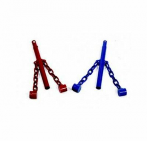

  19. Well Seasoned
    18,016
    83,606
    Best bet is to clean it from the bottom up with a rotary system, or have a chimney sweep do it. When it's clear, you should use an insulated ss liner, but to do this, you'd need to break all that clay tile similar tool to what wildwest put up. This gets done from the top down, removing the clay pieces from below. Can you post any pictures? Sometimes if there is excessive mortar in there, the tiles can be a pain.
    Should you decide to use a pour insulation, thermix works well, it gets mixed with water, then poured down the chimney. The plate at the bottom to hold everything is challenging.
    IMO, running a ss insulated liner is your best bet.
    Tile breaker tool......
