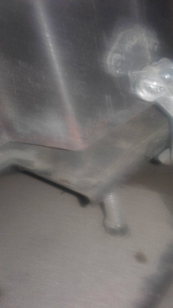

    it's not the right thing. This gasket is a hard rubber, not rope. My camera is just so bad for some reason, i can't get a good picture.
    The top left corner is the remaining piece of the gasket. It's all broken off towards 20190209_140325 (1).jpg the front corner and down the right side.

    Looks like Lennox wants you to buy a whole new cleanout box.Buy a sheet of liotherm,cut a big square,scrape off any old gasket,lay it on the door,snap shut.Or,a better solution,buy a sheet of hi temp silicone gasket material,cut a square,lay in there,snap shut.Measure the gap to get the right thickness.

    Rope gaskets are generally higher temp cause they are right where the flame is.Some pellet stoves use this material as a combustion blower gasket,which would be even hotter than the area you need.It will,however,get hard,over time.Is probably what is on there.

    What's on there is soft.... feels like a bike tube, just thicker.
