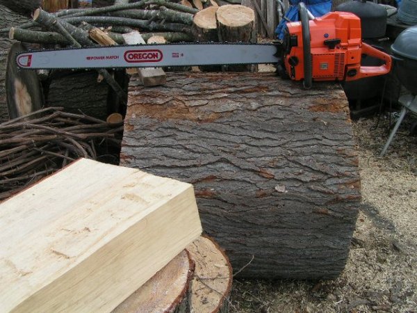

    I just got this ported 2171 today w/ a 75 cc XPW jug on it. :dex:
    But in all seriousness, a Husq 460 Rancher or a Stihl 391 would pull a 24" for occasional use. Or if you prefer the pro build style like your 545, the 2166 or 365 is a great platform.

    Are you serious Dex ? I tell ya what..that is fricken sweet man ! You always find the right bar to match the powerhead too . Nice !!!!!!!!

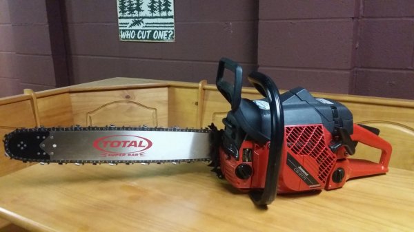

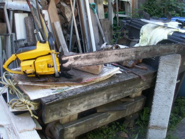

    Here's a stock one...
    And here's one with Xtra Bananas...
