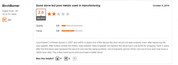

    I'm looking at pulling the trigger on a NC-30 here soon, was reading the latest HD reviews and found a reviewer that has had warping issues with two different NC-30s (sounds like his hearth might not be level). I haven't found any posts here or the other site that mention warping but wanted to ask you NC-30 burners directly. Any warping issues?
    Here's the review:

    Probably an over-fire issue. The 30 has lots of happy users and I don't ever remember hearing of any warping problems.

    Yeah, warping sounds like an overfire.
    Reviews aren't always worth much. JMHO, and review of reviews.:D

    My old Ashley had been overfired and warped the holy livin' crap out of the back panel.

    from his review- wouldn't matter what stove make- he is plain over firing- A stove shop/mfg nightmare customer. Likely of the cut the pine tree down in morning and burn in evening ilk as well.

    My opinion... When reading reviews I usually dont read into just one too much. Look over the whole set of reviews and see common points good or bad. Reading review take away 50%, believe 10%, then use common sense...
    But on Englander... This is my third unit (2 - NC13 and my current NC30)...I did have a issue with my top lip where the door gasket touches off on the stove on my first NC13. It was tweaked/warped, verified by a straight edged. And pics to Mike. Mike took care of it and got me a replacement. :yes:... Great customer service Englander offers. I know of one other unit that had that issue, that was on the other website. Thats where mine was documented at too. Great units, I wouldn't hesistate to buy another.

    I could only imagine the abuse those stoves took in order to sustain that damage. Both stoves from the reviewer have probably never seen a stove thermometer in their life.
