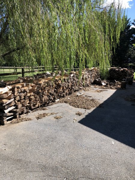

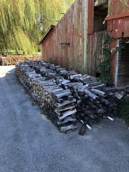

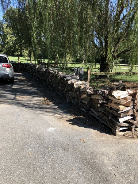

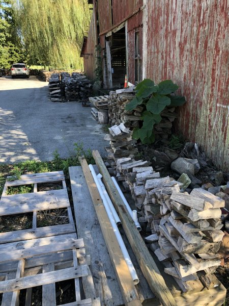

    Hello all. Attached are photos of my wood stacks. I’ve been seasoning the red and white oak for just under two years approximately and the moisture levels are about 25%. Wondering if anyone has any tips for getting a few more percentage points off in the next few months. Hopefully by January. I live in Delaware and fortunately the winters here haven’t been as cold as they used to be. Don 3AF84A6A-0052-4350-9198-4E67B33B3333.jpeg D410499E-5EFD-4E4D-92EE-46A6312762E4.jpeg 7833EDC3-F770-483D-91D7-82B81CA79122.jpeg C204B79D-DC97-4EDC-87CE-3D45F4F34F24.jpeg D1CFB2A6-563D-40B2-B4D2-364F48E50A95.jpeg 66F569B2-414C-4836-9156-AECA88B60A38.jpeg 5237F51F-13EF-48DC-801C-1E44C1C58490.jpeg FCC80FFE-ECA8-47DC-9E92-61975EDD2A78.jpeg 5E395FAA-7E17-4F1E-ABA8-E2B6FA4D8263.jpeg 207CCFAB-C38A-4018-828E-5FDEEB107CD9.jpeg

    Covering your stacks would help.

    I too think top covering will help. Looks like that could be a challenge with lots of long runs.

    I found over the past few years that firewood that I had stacked close to a shed or other building did not season as quickly. Looks like you have a few stacked up against the barn / house there. You might see improvement if you had that in an area where the air / sun could hit it from all sides, optimally.

    I would stack what you plan on using single rowed with the stack pointing due North in the sunniest part of that field ASAP. That orientation gets the most sun and single rowed gets the best airflow. Stack the splits loosely too. The stacks in the shade look damp compared to the one next to the chipper in full sunlight. As stated ive experienced how much slower wood dries in the shade next to a building, but thats really all i have as an area to stack it. PITA to move stacks but thats my 2c worth.

    268,766
    I looked at the first picture and knew right away what your problem is and then more pictures supported this. Stacking wood next to a building is not the way to dry wood unless you have lots of time. To dry wood, the number one thing is air circulation and if something is blocking the air... In addition, as others have pointed out, the wood should be top covered. Yes, wood can dry without being top covered but I am convinced you lose a lot of btu by not covering, especially when the wood has set for more than a year.
