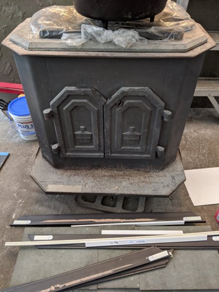

    Finally getting rid of the 40-year-old Garrison II that came with the house. Had about enough of a windowless, leaky, hard-to-load, warped door, crappy air vent location smoke dragon. It will be going in the back yard and converted into a maple sap evaporator in the fall.

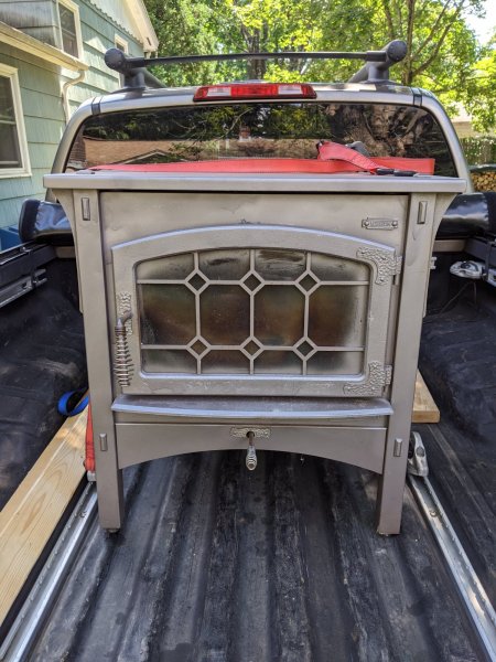

    On Saturday I bought a used Avalon Mission from a guy off of FB. Electric blower works, air tubes in tact, and aside from a few minor cracks in a fire brick or two it's in great condition. Perfect size for the house. Even gave me 10 feet of double walled pipe with it. Going to replace the gaskets, clean the glass, possibly replace a couple bricks and paint it dark red. Nice that it will remain outside for a while and I can do the paint curing process without stinking up the house.

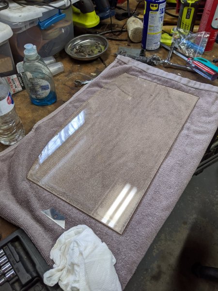

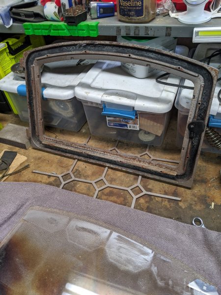

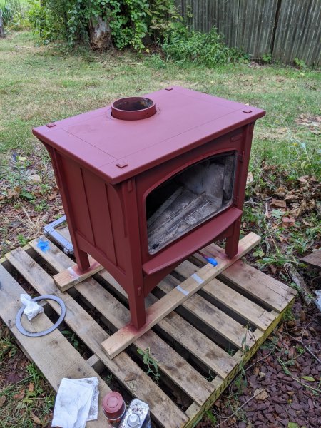

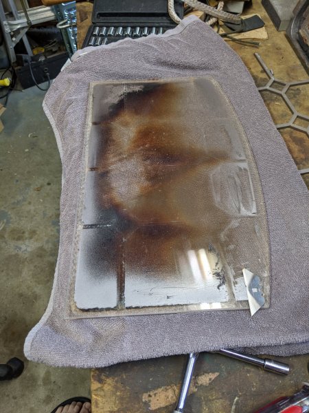

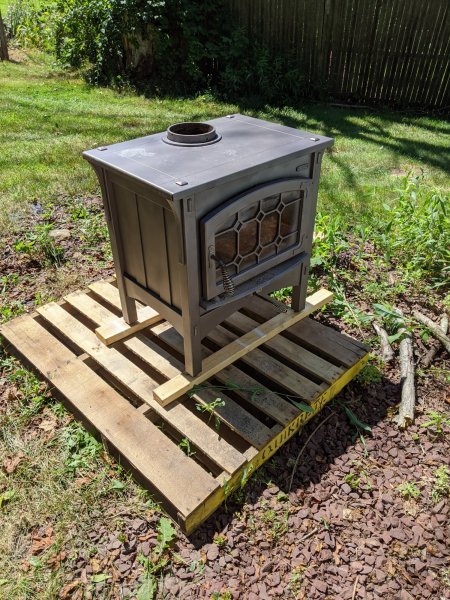

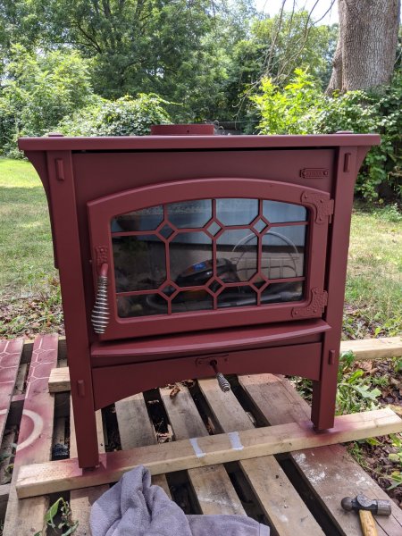

    Had a day to myself today and got to work on the stove. Gave it a good vacuuming out and left the fire bricks inside for the time being so I can do the curing burn. Dismantled the door and cleaned the glass. The previous owner had painted the stove silver and didn't really do an exemplary job... see the before photos to get an idea.
    After the stove got three decent coats of Mojave Red I reassembled the door with new gaskets. Waiting a few hours before I get a fire going.
    Once the curing burn is complete I'll clean it out again, remove all the fire bricks (and probably replace one) and beg my brother in law to help me schlep it down the stairs. After that it's just cutting the stove pipe to the right length and waiting for the cold to get here... not soon enough if you ask me.

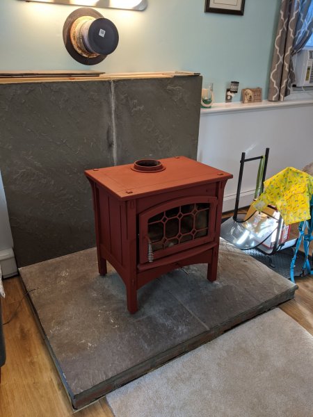

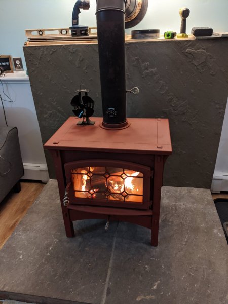

    Curing burn complete. It definitely darkened the color a bit. My buddy came over for dinner tonight and I convinced him to help me schlep this thing down the stairs. Next step is painting the stove pipe!

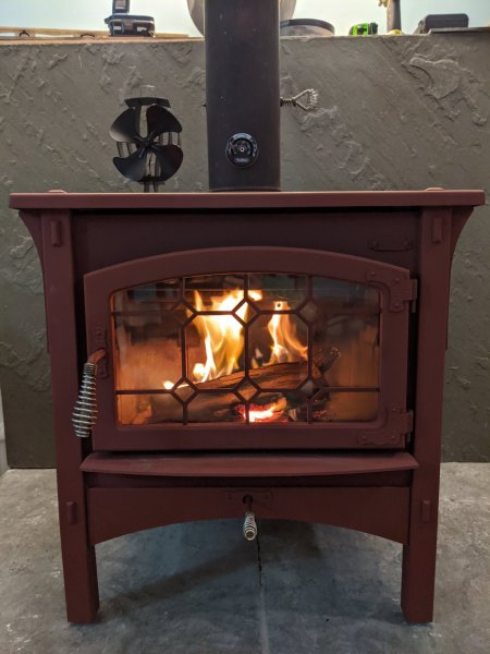

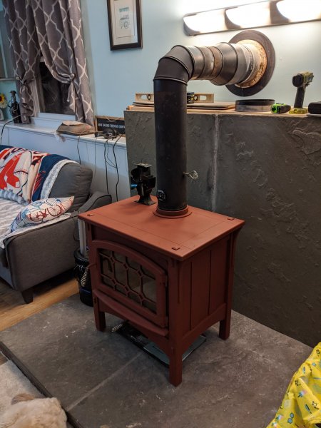

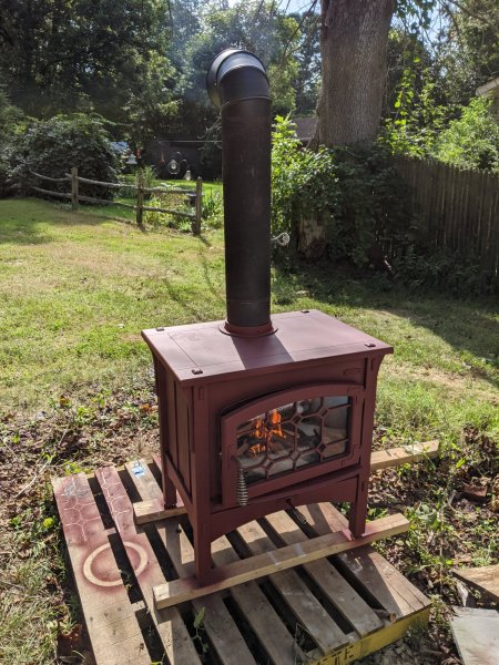

    Weather is starting to cool off and I've been itching to burn. I cleaned out the pipe and got it fitted last night. Probably going to replace a 10" horizontal section, remove the entire pipe, and put it on the old stove outside to paint it black. Once the curing burn is complete I'll put it on the new stove. I cleaned out the thimble as well, and I'll get on the roof and clean the chimney this weekend.
    While I was sitting there after dinner, admiring my handwork with a glass of wine, I thought "Well, might as well throw a few sticks in there and make sure she's drafting!"
