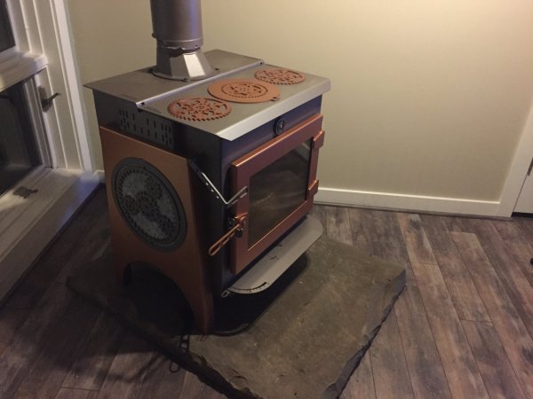

    Here is the stove installed. I couldnt be happier how it looks.
    That is 3.5 inches of bluestone. It was unbelievably heavy.

    Could be the picture, but do you have enough clearance to the combustible floor on the sides? Check your data plate on the back to be sure.

    Yes, i am at exactly 6 inches from the stove sides per the manual.
    I also have a .5 inches of cementboard under the slab to give me the .41 minimum r-value.

    Did something horrible happen to the bottom of the stove pipe?

    Yes, sadly it is a "reclaimed" stove pipe.
    I plan on clipping the metal lip off and painting soon.

    Its a nice piece well done! Im guessing that when the stove is on a slab of something the clearances for combustibles are reduced to nothing? Ive just never seen a hearth that small!
