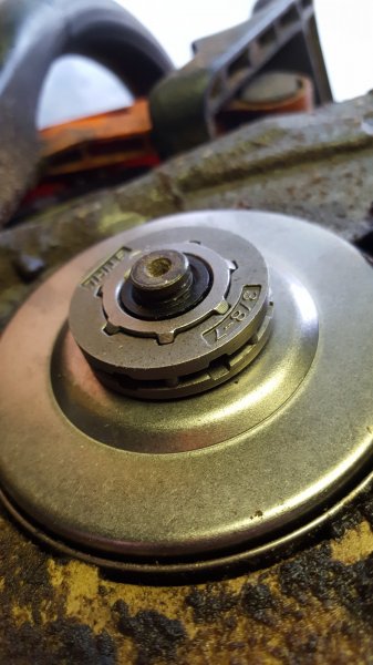

    Finally remembered to take a pic of sprocket when i was home...
    Time to replace? I need to look at bar too, probably time for a new one, may be why there's multiple 'gouges' in sprocket?

    ive seen worse but yes id change it

    Yes. It's time for a new sprocket. You have 3 groves on each tooth. Not only is the drive Link touching the sprocket teeth but the top link/connecting bars are cutting into it.
    Your chains will wear out faster. Sthil chains have a wear indicator on the bottom of the tooth link. Normal bar wear usually won't kill a chain on the link bottom but extra sprocket contact will.

    Fifelaker said "yup, inboard atihl, my mistake"... What does that mean?
    Ah so thats what the 'side' marks are.. Does that just happen over time, or is there another issue going on that causes it?

    normal for spur just needs changed and would be better to go with the rim drive

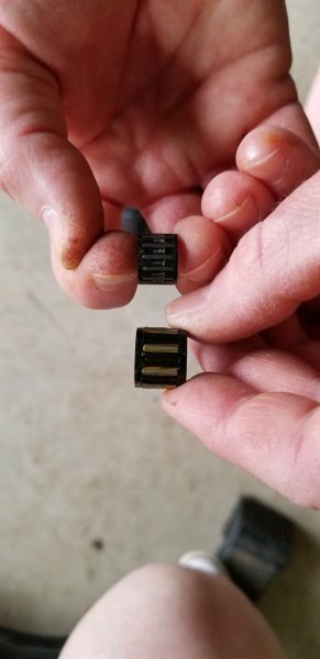

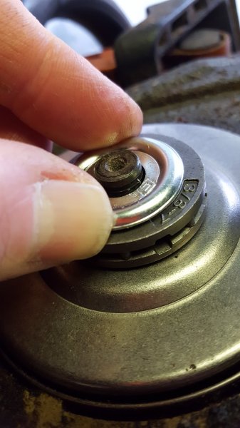

    Finalky ordered the sprocket, putting it on. Have what seems to be a problem. It came with a bearing, but the bearing is bigger than the original. The issue is the "length"...it is a bit long, so once i get the washer on I cant get the clip on. Cant use the old bearing because hole in the new sprocket is sized for the bigger bearing...

    Will the e-clip fit if you flip the washer over?

    Negative, tried that.
    Even tried the old washer...its larger around, but more saucer shaped..the outer edge isnt as bent or 'rimmed' so a more gradual taper. Thinking this would allow the clip to get in there..no dice.

    Well,. The big bearing appears to be the correct one for that sprocket. It sits flush with the outer surface of the sprocket shaft. Is the clutch drum is sitting correctly with the slot on the oil pump drive arm? For a quick fix I would sand or file the c-clip just a bit thinner to get it on.
    I've done it on drive shaft ujoints to adjust preload when they were replaced.

    Yeah the drum and sprocket fit good, and the slot is right. The problem really seems to be the bearing being a bit too "long".
