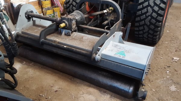

    This was the first time I've run this mower with new hammers.

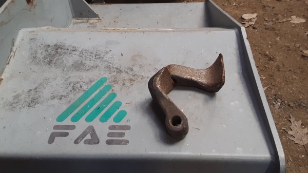

    It's a flail mulcher that I bought used last year. This is what the "hammers" look like.

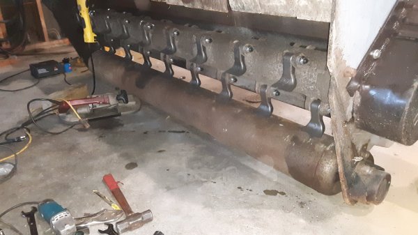

    These are some of the better ones that I saved after replacing them all. $32 each and there's 27 of them. It also needed new nuts and bolts. :eek:
    The porta band and grinder with a cut off wheel were required. Many of the bolts required cutting on each side of the hammer to remove. :headbang:
    It worked well and did a better job than my rotary cutter. Both are 8'. This one can offset to the right about 2', that is handy along the edges and under limbs.

    I'm hard on "blade's" .... or all the friggin rocks around here are! :whistle: FAE calls this a "flail mulcher", they do offer a "knife" that's for much lighter material (cutting).

    The FAE parts distributor for the North east is in Quebec. I don't know if my particular flail takes a specific knife or hammer. Being somewhat lazy I might have saved on the costs searching the web for an alternate. Needing the hardware I spent over $1400 on these *27 "hammers" but it is a $12,000+ mulcher (new) when I searched buying this one 2nd hand.
    I can measure the dimensions of one fyi if it helps. They seem to be forged and the FAE emblem is embossed in each hammer.
    * 3 rows - 9 hammers each
