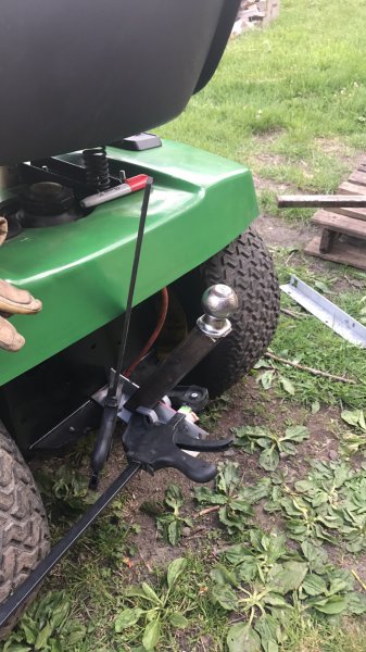

    starting to look like something! Fabing up the hitch tonight! I think I am going to change the design and make it a slide in reciever hitch so I can use it for other things too.

    Cool Pete. Is that the mower that scooted your truck better than the other?

    Pete, you think that mounting plate is strong enough? Maybe tack on a piece of angle underneath.
    I guess it depends what you plan to tow. Gooder idea to put the ball up high, that should help with clearance when turning.

    It's going to have angle supports to the back and a solid bar wrapping around the sides for support the plate won't be doing much at that point. I am not done mocking it up yet I got lazy..

    No I sold the simplicity's :whistle: this was in good shape and hydrostatic so I couldn't pass it up.:D

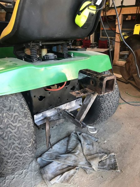

    Before you start welding , Don't forget there is a gas tank right there:)

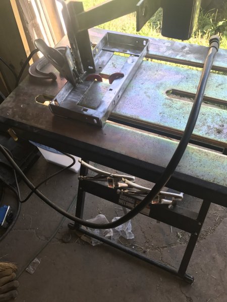

    I am welding it on the table:D the vent tube is right where the hitch sets I could see a boom in the future with that...

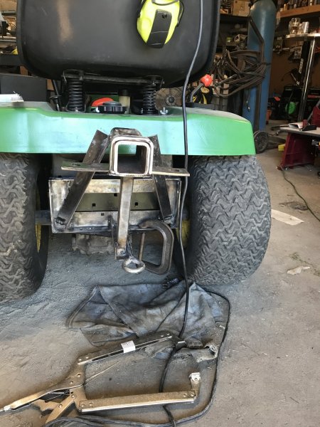

    Mower hitch continues. This is taking forever:rofl: :lol:
    There will be two more supports going to another section of angle bolted to the tractor up under the seat too. They will be welded off the receiver sides possibly. I hadn't really thought that far ahead yet. On the bright side flux still looks terrible but it's strong!!!

    Is that a 165, 175, or a 185?
    I'm assuming you want to tie the top of it to the mower frame somehow too.

    Yes I'm mocking it up right now. I'm just not to sure how or what I'll use for the side supports yet.
    It's being put together out of my scrap pile so I am digging and cutting until I like what I see.

    Ugly welds but it's together!
    Seriously thinking about running frame mounts down the side to the frame and bolting it on under the seat too. Way overkill for a 185 Hydro:rofl: :lol:
