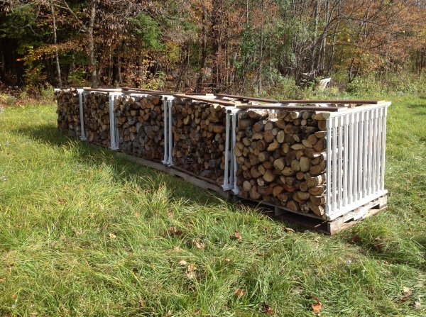

    8C8557A1-53F1-4AA3-9442-A5F568493186.jpeg 36202135-6150-4624-8158-501E89693009.jpeg 2EC9FFCE-8F8B-400B-A099-D85B5EF6D921.jpeg

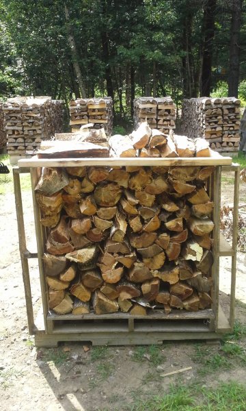

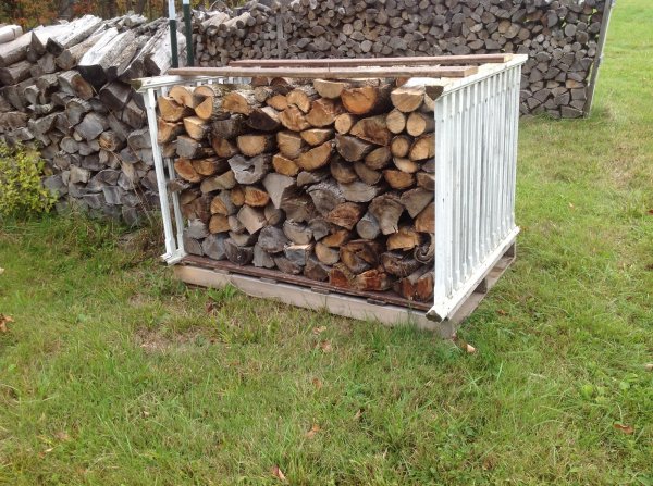

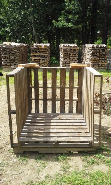

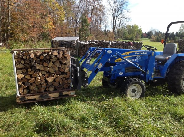

    I have single row racks, they are lighter but tip over easy. I like the stability of the pallet racks. I screw treated lumber to the bottom and use whatever I have for sides. I’ve been putting steel roofs on them as well.

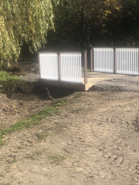

    I took some of those apart and made a Bridge.

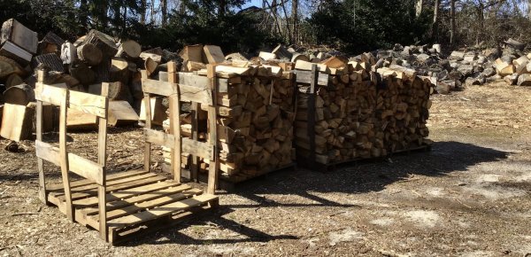

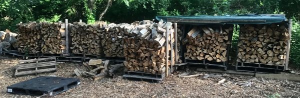

    I use pallets a lot but I would not move them into a home space. I tried it and as I used the wood I found empty mouse nests. The mice had moved in!

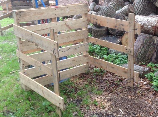

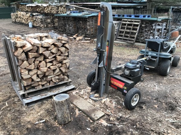

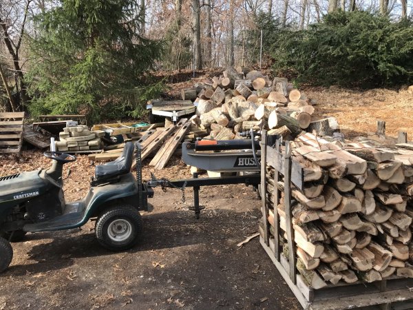

    These pics are how I'm making the pallet racks now
    Most wood is from pallets taken apart
    The empty ones are on their side so I can move them with a hand truck
    You have to look close but there are two strands of wire across each of the uprights.
    Wire is unwoven from black chain link fence. It holds up well and keeps sides from spreading when I'm moving with tractor.

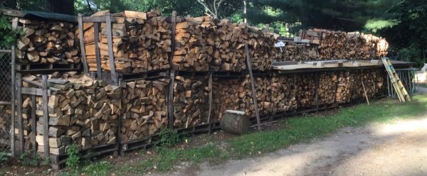

    This is what I split since last fall
    Not all covered up. has to sit out for a couple more years. will cover before leaves fall!

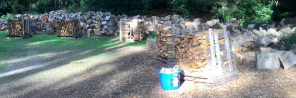

    I always put a sacrificial pallet under the one loaded with wood. I have also used runners 4x4 or 4x6.
    I use softwood or generally poor pallets under the wood pallet. The only last a few years. For the firewood pallet I use hardwood pallets and they last a long time and are strong.
    In the pic below you can clearly see the sacrificial pallet. The pallet holding wood is one of the first ones I made 11 years ago.

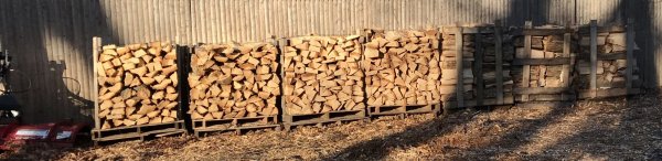

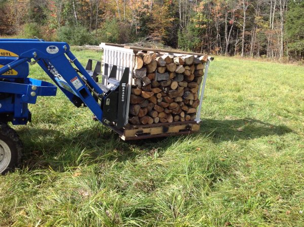

    2.5 x 4 x 3... a scant 1/4 cord is about all my tractor wants, it'll lift it about 2 feet, just enough to move it around.

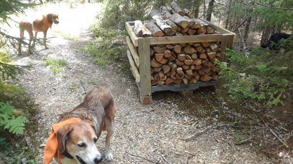

    Pallet bin with a sacrificial pallet underneath (not screwed to anything) and can also be put on top of cinder blocks for the winter.
