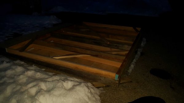

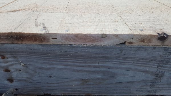

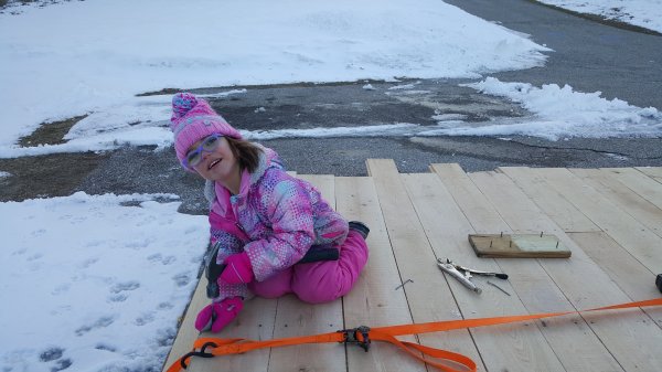

    Last Saturday I finally got started.
    The foot print is 10x10, 2x6 wolmanized salvaged from our first sap pump house. The "joists" are wolmanized 5/4 deck boards. Not ideal, but the floor will be oak, so plenty strong.
    I may have gotten farther, but I had "helpers". I am ok with that.
  3. The Wood Wolverine
    17,938
    113,947
    Have to admit, you sent me to google for wolmanized. :emb:
  4. Warner
    Warner
    Jun 19, 2017
    7,222
    46,452
    Me too!
  5. eatonpcat
    9,688
    54,052
    Youngins!!
    I don't like the 5/4 boards as joists, but it looks like you are off to a good start....Cute laborers to boot

    I don't either, but it is what I had. The floor will be 1" oak, and I will support each "joist" in the center with a cinder block once I move it to the final location.

    You could double up those stringers for a little more rigidity and don't forget braces so the floor isn't bouncy.

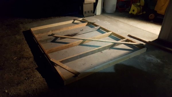

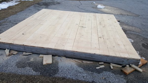

    Finally finished up the floor, I actually pulled about 1/3 of it off after I started and shiplapped the boards knowing that they will shrink, so it should minimize the gaps and critters that can get in. The boards drying remind me of a steak cross section....mmm steak...
    I am not worried about bounce in the floor, the joists will be supported once its set in place, and that red oak isn't real forgiving in the floor.
    Going to see what I have for 2x lumber now to start on the walls and trusses, may have to rip some down on the mill or tablesaw 20230319_193034.jpg 20230321_192319.jpg

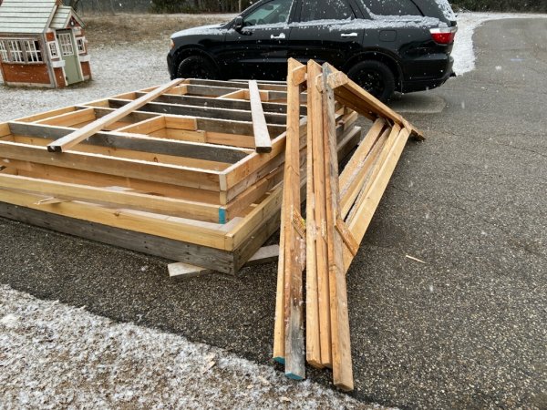

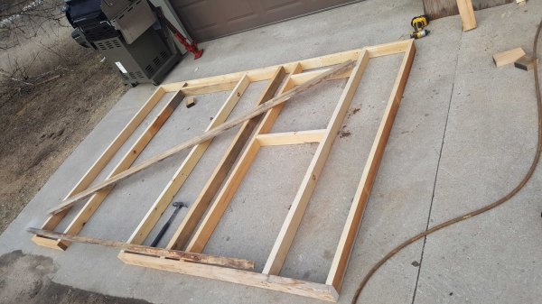

    2 weekends away (1 at my parents for Michigan Maple Weekend, 1 in the UP) has not helped the progress.
    But I do have 3 out of 4 walls built. Hoping to have 4th wall done by end of the week and build the trusses this weekend.

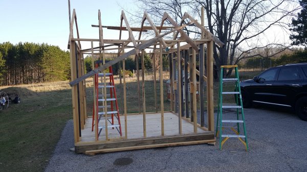

    The Mitten
    Everything went vertical this week. Hoping to finish the roof and start siding this weekend.
