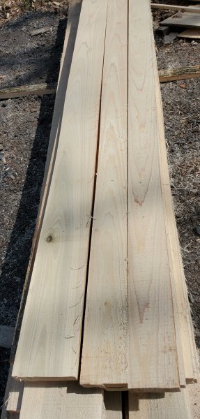

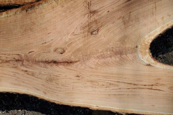

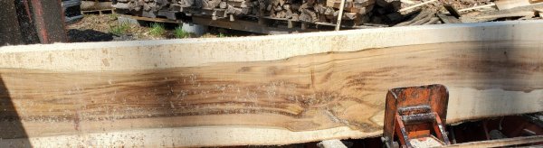

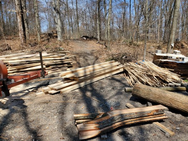

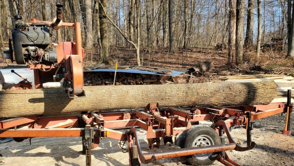

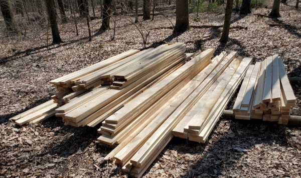

    With current pricing and availability of lumber these days, I decided to clear out a few subdominant poplar trees and have them milled into framing lumber. Ideally, I would like to build a solar kiln for drying lumber +/- fire. However,t out here on the farm we always seem to be using 2x4's etc. for small barn, etc. projects. I should be good-to-go for several years now. We also milled a little cherry crotch, a small red maple and made a bunch of sticker for drying said lumber.

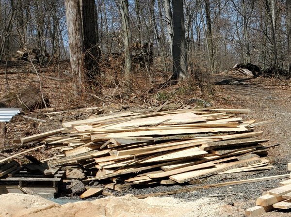

    BTW, made a nice pile of slabs for firewood. Poplar ain't the best, but it's already 3/4 way to C/S/S. It would be great for someone with an OWB. 20210406_135419.jpg

    Very nice lumber Mike.

    makes great firewood bundles also

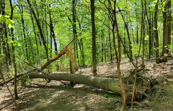

    Might be some more milling in the near future. This red oak was about 1/2 dead and got blown over yesterday by high winds. It's 28." dbh and 45 ft to the first branch. I hope the wood in the trunk is still in good shape. Took out that crappy black gum on the way down. 20210501_124241.jpg In addition, I have another 24" dbh white oak in the same pature that died over last winter. We shall see.

    Poplar is an excellent substitute for softwood framing lumber. It is a little heavier than softwood, but nowhere near oak or other hardwoods. Nails and screws well. Very stable once dry. It has very low rot resistance, so also similar to typical softwood framing lumber, not pressure treated. For furniture it is an excellent "secondary wood" for inside drawer, backs of cabinets, etc.

    Some nice looking lumber there Mike. When you mill do you cut to the full size 2x4 or the finished size of conventional softwood framing lumber? It gets used as is and doesnt get planed?
    Steve likes this.
  17. mike bayerl
    mike bayerl
    Nov 15, 2014
    3,886
    22,152
    I cut final size and just use it unfinished.
