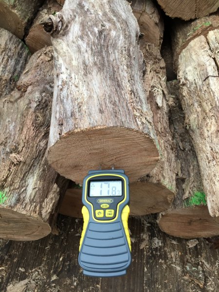

    I use it just to see how to stack fresh cut trees.
    As you can see this Red Oak I cut Saturday is good to go. No need to split to check as it's 17.8% in the hart wood. Like others have said if you have the room get to the 3 year plan. But if you are just starting out they can help you find out if the dead standing or blow down your working is good to go.

    Freshly cut and immediately stuck with the MM? As in.....right then, as soon as the chain clears it?
    I would ask if you would indulge li'l ol' me, split that and give it a stick- if it's the same, I will shake your hand via the internet:thumbs:
