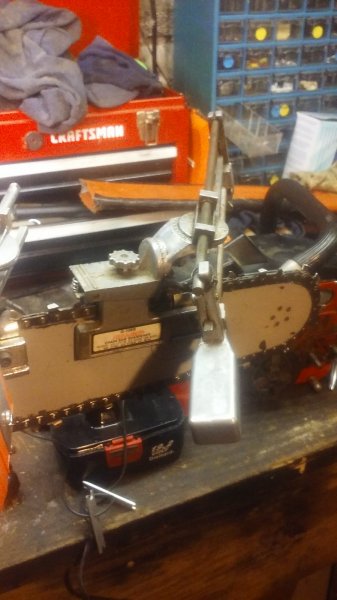

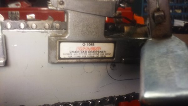

    I like the Granberg File-N-Joint to get things back in shape.
