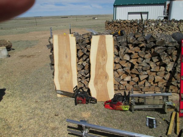

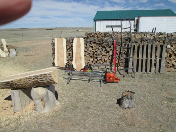

    Was able to get some ash the other day and decided to mill some and use the rest for firewood. I have to say this is sure some good looking wood. I already have plans on what to make with it. How about a few pics.
    I got 5 pieces out of this one log at 1 1\2 inches thick. I have one more log to do.

    What size saws you running on the mills?
    Bigger one looks like a Husq, not sure on the smaller one.

    The larger of the saws is a Husqvarna 2100CD. The other saw is a Poulan 505 with a Stihl MS660 piston in it. The smallest saw there is a Poulan Predator 54cc. I am running square ground chain on all of them.
    The Husky is 99cc the Poulan 505 is 83cc the Poulan Predator is 54cc,

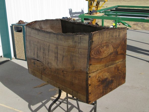

    So the wood has been sitting inside my garage now for about a year and 9 months. It warped pretty good while in there. My own fault since I did nothing to prevent it.
    But anyways I have been working on the firewood box and just used the wood as it was. I did do some light sanding on it but that was it. I stained it dark since that is what a lot of the furniture I have now is.
    A few more coats of verathane and it let it dry then ready for use. This will be a huge improvement over what I am using now. Should be able to hold a full day of wood for me.

    The box is very strong and heavy. It should work great. Just a firewood box and nothing fancy about it.

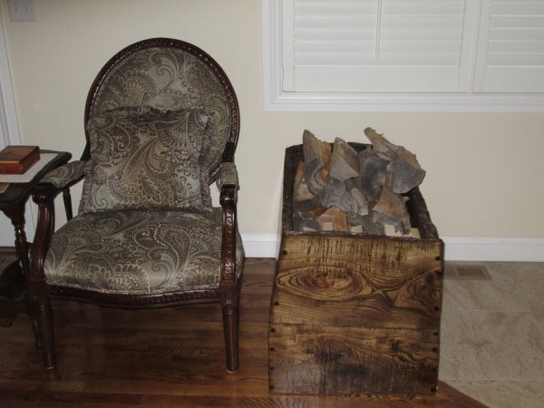

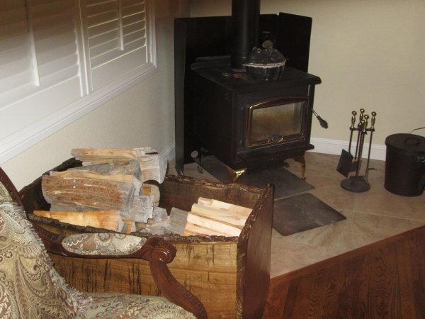

    Ok finished and in the house. Holds a days worth of wood easy. Maybe even more.

    It is 37" long, 22" wide, and 24" tall. Thanks.

    I think the warp turned out perfect in this case ;) Good job.
