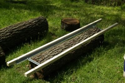

    Another thing to consider is first cut guides. Granberg sells rails:
    There are alternatives.

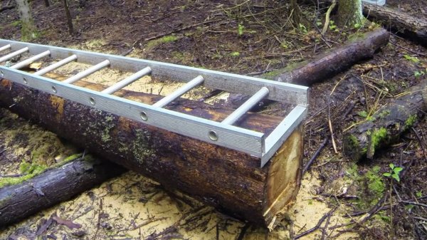

    I use mostly 2X’s, but I have used an old ladder.
    First cut is like laying the foundation for a house. If it’s not straight, rest of the slabs will be wonky.

    Sooooo... The guide rails, 2x4 or ladder, must be leveled on the log in order for the first cut to be straight?
  4. The Wood Wolverine
    15,839
    97,727
    Yes. I typically use a 2x6 or 2x8 screwed to the log. Measure each end from the log center up and have your board the same measurements so you cut through straight. If you have to, shim the center or ends to keep the weight of the rig from sagging anywhere.
