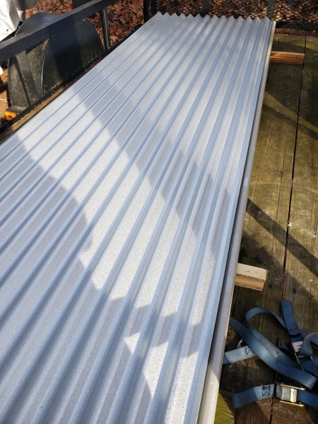

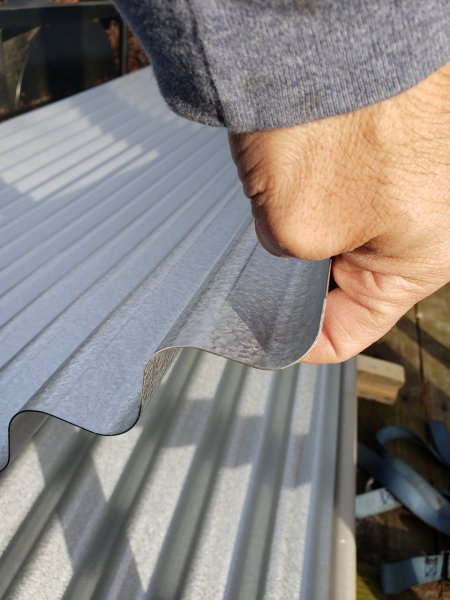

    Took the trek over to Delaware yesterday and picked it up. Man this stuff is the real deal, really nice fella, even gave me a half a bag of fasteners. Indicated he bought for a roofing job about 5-6 years ago, been sitting in his warehouse for all this time, decided to recoup some of the money on it. Said he paid $38 and change per panel, he sold it to me for $19 a panel 10ft by 36" 22ga. Considering HD is selling 10ft by 24" 31ga for $18, I'd say this was a great deal!

    Thats some nice looking roofing.. Great price..:)
