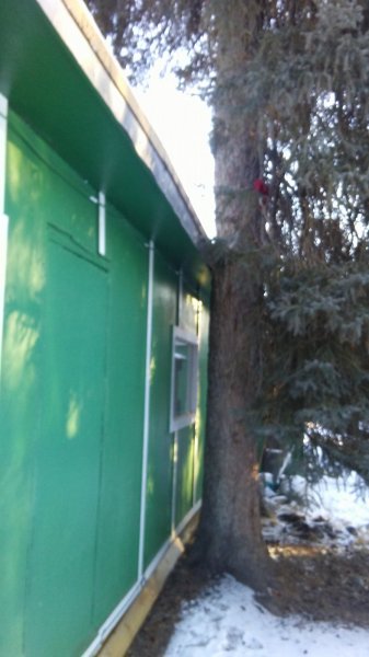

    I only have a few hobbies . Now that I'm mostly out of the business. This is one of my hobbies. 20171111_112457.jpg 20171111_112431.jpg 20171111_112417.jpg

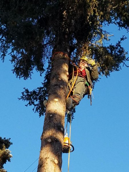

    White Bata bunny boots work great in the spurs. Hand saw is a Samuri Itchiban . chain saw is my MS251.

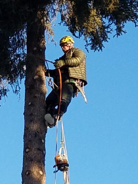

    Limbing old White Spruce is not the greatest fun in the world. The breeze blew a lot of the dust away. So I didn't have to breath it as much. Resized_20171118_123909.jpeg . Fingers got so cold I had to warm them up on the muffler.

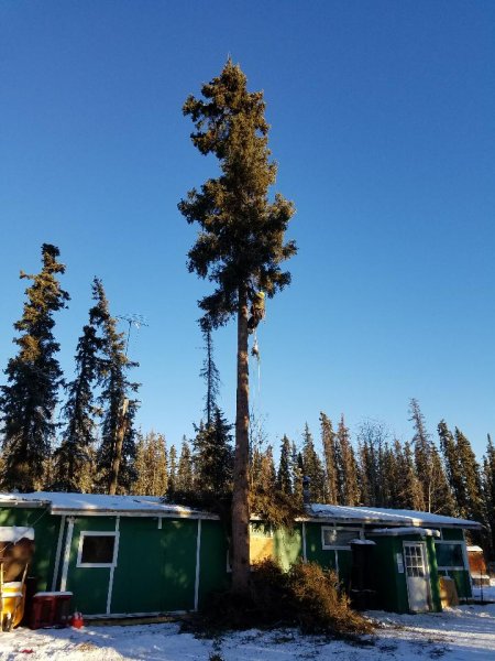

    Resized_20171118_124155.jpeg still going up.
    The home owner was my ground man.

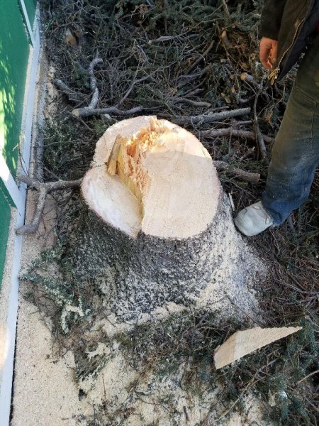

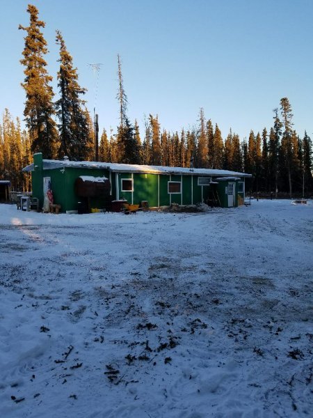

    Resized_20171118_132613.jpeg Resized_20171118_132554.jpeg Resized_20171118_145811.jpeg
    Another successful tree job . On the ground and on the hat.
    I hung 1 pulling line in it . Tail holted to a smaller spruce. Used a Petzel small acsender on the pulling line . 1/2" Sampson Double Braid. Used a rope come along to tighten it up , and give it a light pull with.
    Put a nice deep face in. And put in the back cut. I wanted to get most of the sapwood cut. As soon as I did most of the holding wood broke all at once.
