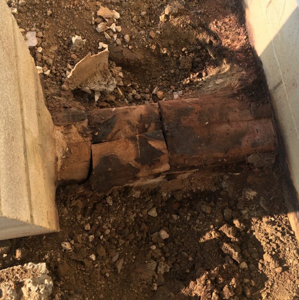

  10. Ohiohunter
    Ohiohunter
    Feb 13, 2016
    10
    22
    The old clay section that I started braking up. I'm from norther ohio

  11. Locust Post
    8,787
    50,887
    Wow.....I have never see anything quite like that, with the chimney out from the wall. I don't really like the idea of class A for that, given it will be laying on the ground. Others may disagree. I believe if it were me I would dig down far enough to set concrete chimney blocks sideways then either run your class A through that or drop a liner and put an insulated stainless connector through there.....just some thoughts.
    Eric VW and wildwest like this.
  12. Locust Post
    8,787
    50,887
    You should also have a slight upward rise in that section, not just level.

  14. brenndatomu
    23,457
    150,712
    Wow, that's...uh, interesting. I'm with LP on this one, never seen anything like that before!
    I don't see why you couldn't replace that with a section of class A. You could put chimney blocks in as Locust Post suggested. Me, I'd just dig out the width of the chimney about 6" below the pipe clear back to the foundation, then put "retaining walls" on the sides to keep it dug out, like a window well. As LP said, you will need to make sure there is rise on the run...IIRC 1/4" per foot is bare minimum, and 10' maximum horizontal run... and even that far will perform poorly. And yeah, an insulated liner in the chimney is a great idea too.

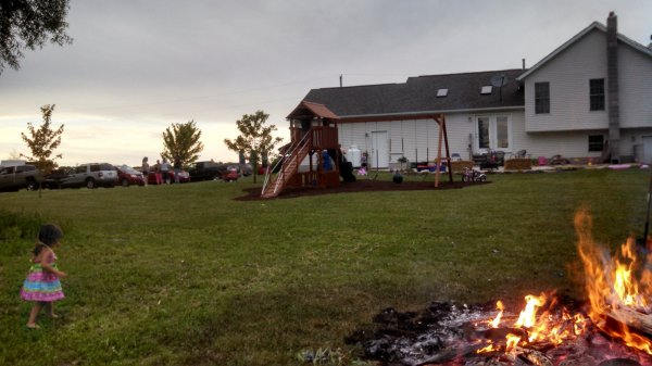

  17. Ohiohunter
    Ohiohunter
    Feb 13, 2016
    10
    22
    Picture of chimney in back ground
    Eric VW, wildwest and fox9988 like this.
  18. fox9988
    fox9988
    2,709
    8,275
    NW Arkansas 72717
    Very unique setup. Class A has insulation between the double wall stainless. If you bury it in the dirt, the insulation will get saturated with cold ground water. If the exhaust temp falls below 212F, the moisture in the exhaust will condense causing creosote build up. Not good. I'd keep the Class A open as brenndatomu suggested. And dry.

  20. Locust Post
    8,787
    50,887
    I knew before you posted the last picture from a distance, what you were saying. The correct way to have done that chimney if they wanted it right there would have been to put it flush against the bottom where you have the issue and then run it inside the house through the overhang section. Would have looked better as well. Not faulting you though, just commenting.
    I don't know about the retaining wall idea as it would be a debris trap for leaves, maybe mice in the winter with the nice warm pipe, of course unless I am not understanding it correctly. I thought of the chimney block because it would be closed on all sides.
