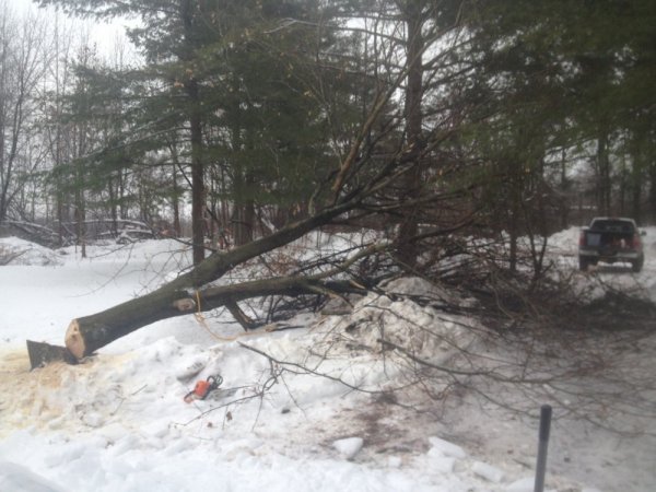

    A little tension from the truck and down it goes in the right direction. Guaranteed.

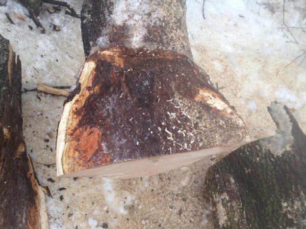

    It's not a huge tree but it will yield a truckload or so. Looks like it was a little sick inside??

    Yes! I think it was. Some of the branches in the middle, top were dead already. Who knows what was wrong with it. Glad it is down, and glad I've got more wood! :drool:

    Look at the crotch where the tree divided right in two. Now I'm no expert by I did not cut hardly any of this crotch. What these pictures tell me is there was not a lot holding the two main sections of this tree together. o_O

    Tree had co-dominate main stems, two main leads instead of one dominate lead... Usually on a small tree you remove one.. That's a weak spot of tree usually requiring cabling as the tree matures and the leads have more growth adding weight.. Depending on how the two leads are joined determines how strong they are... Included bark is bark that forms where they join but is growing inwards leaving what looks to be a crack and allowing water to enter causing rot and pathogens to enter like in your case... Occluded bark builds a strong attachment point looking like a small mountain of wood around the area the two leads join...thus growing outward.. These are the trees you usually see storm damaged.. I learned about these things in order to make a sound decision about climbing and tying my lifeline into one of these leads... Sometimes when when removing this type tree climbing, I would actually rope the two leads together half way up so I could work the tree down safely... Looks like the tree was getting heart rot.. A good tree to remove considering the weak attachment of the two leads,, what we called a hazard tree... You wouldn't want that tree around a back yard swing set or near a highway... You did yourself a favor taking it down in my eyes... Nice job for taking the time and setting a rope as to put things in your favor, especially around energized lines... Thanks for posting!:thumbs:

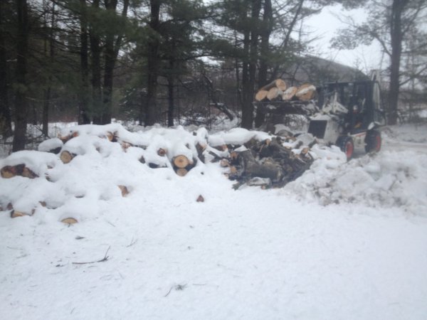

    My father had planted these trees many years ago. The family got many good years of shade out of them. And now the will help heat my home next year. Four and a half bucket loads for the pile!

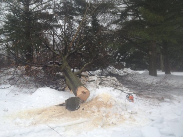

    Sometimes I cut at an angle on the back side to sort of leave a back up or support in case the tree starts to lean the wrong way for some reason. This can give you another option if things start to go wrong, if you don't cut all the way through and the tree starts to lean back on you then it will hold the tree there, hopefully, till I figure out WTF I am going to do then. :zip:
    A notch was cut on the side of the tree where I wanted it to fall. Then when cutting down at my angle toward my notch I was off a bit with my cut. :emb: Soooooo, I had to restart my cut at a better angle and by the time I was done it looked like I had cut another notch on the back side. :emb: Thanks for pointing out my poor cutting. :(
    :rofl: :lol: Just kidding. But anywho! I got the job done and the tree is history. :rofl: :lol: And I always enjoy doing that type of work!

    Just for future reference Gas, you gain nothing by cutting on an angle and will always have better luck by cutting straight. If it does lean back, the wedges take care of that. If too much lean back and you still have a good amount holding the tree, you can always make a new notch above where you were cutting and cut the tree down as if that is they way you intended. After it is down, then cut off that bottom part you had originally started. Naturally if you are pulling it with the truck or something else, then for sure you notch it toward the truck and simply keep some tension on it while cutting the tree. Keep a close eye on the kerf. When you see it begin to open, time to motion the driver to increase the tension and get it down while you are getting your backside clear of it. If course that means a 45 degree angle away from the tree. Of course you have had this planned before you even made the notch. ;)

    I agree with Dennis on your cut... It's very hard to judge how much hinge wood you have coming in at an angle.. Make your face cut and come in even with your bottom cut.. When your done you should see two flat cuts on the stump with hinge wood left towards the front cut..
    If you needed wedges on an angle cut, in my instead of opening that cut I believe it would exert a lot of pressure trying to push the tree off of the hinge wood , where's a flat cut would lift the back of the tree open..thus rocking the tree forward on the hinge wood... Video shows basics.. I come in even with the back cut...
