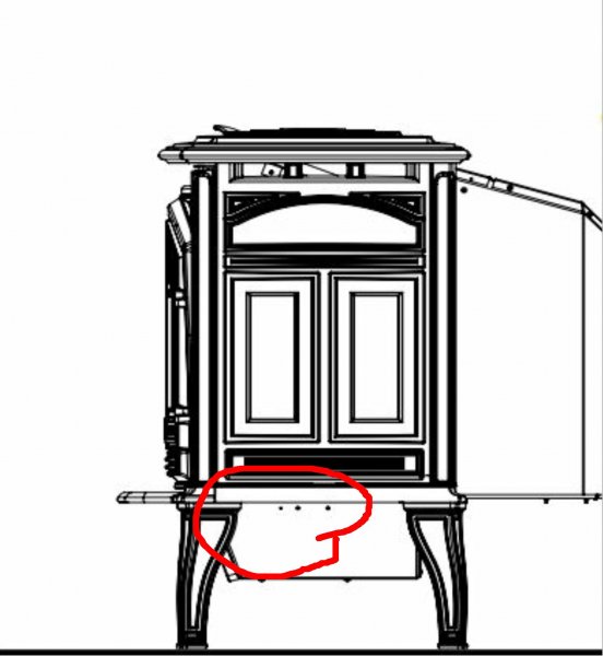

'Lo all, I picked up a brand new Dwyer MKII for short money a month or so a-go. On Freestanding Enviro M-55C where do I hook it up? I hear rumors about a small test port hole in the ashpan area but I cant seem to find it? If I have to make my own.....where is a good spot? Thanks, ---Nailer---
No idea about Enviro stoves (or if it might be a similar place on all stoves), but jtakeman has ans Envoro and pretty sure he has experience with a magnahelic so he may be of some help here.
Shouldn't have to make your own, There is a 1/8 hole on the right side of the ash box. I think its in the front upper corner.
Jay, You 'Da Man. Left most hole shown on your drawing. Bing, Bing, Bing.......we have a winner! Thought I'd seen every inch of this stove.....guess I missed that inch, lol Now to hook it up.......... Thanks again, ---Nailer---
