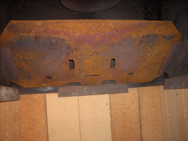

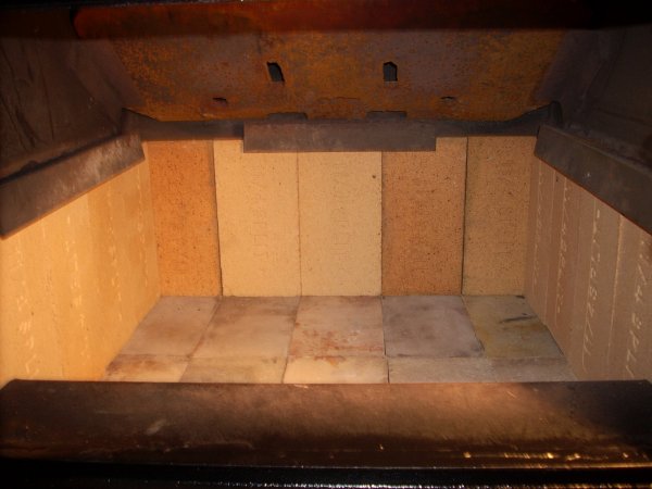

  6. WeldrDave
    9,278
    48,415
    Here is my baffle in Grandma after I painted and re bricked her. I cut some smoke holes in it, which helped with draft Immensely. If I had a southerly wind, I would get a "smoke roll" out the doors when I opened it if I was just lighting it. I did this to create a draft pull and it cured it! This is trial and error in my application because I'm right on the Coast, may not apply to you.
