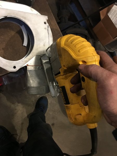

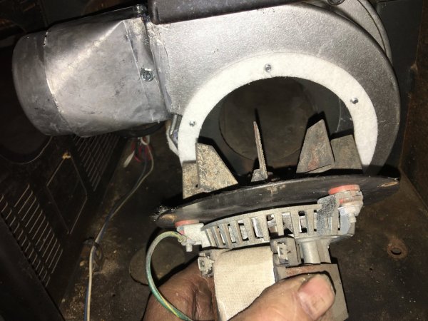

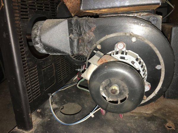

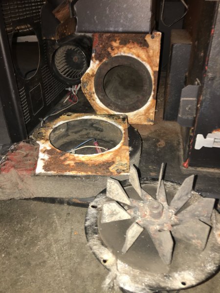

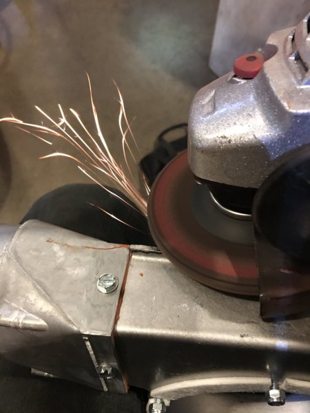

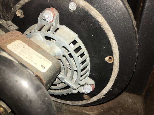

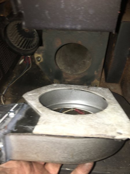

    Anyone do this to their cb1200 Quadrafire Classic Bay???
    After cleaning the exhaust blower and then when it is time to put it back with a new gasket and screws it is such a PITA to line up the gasket with the blower and get the sheet metal screw in! Sure I can do it but now that I have a few mins, let’s make it a bit easier for us older folks?
    All you have to do is get a nice studded housing and flip the exhaust Flange and trim off the top bolt hole and bingo bango it goes right in!
    Now I can push the new gasket over the studs after a good cleaning and easily put the nuts on and snug it up!

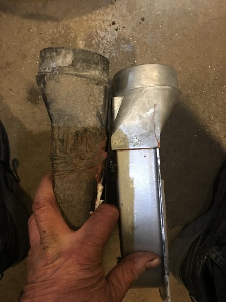

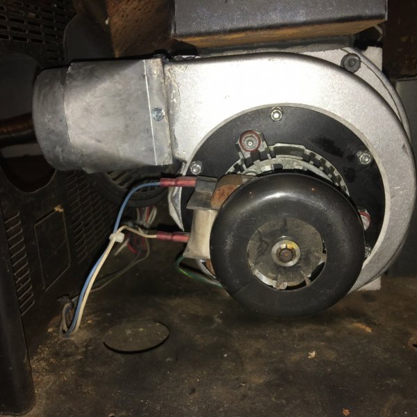

    Here is the final pics. :)

    Great work Don, i never was much of a tin knocker, it looks better than the original!
    Thx Cliff
    don2222 likes this.
  5. don2222
    don2222
    Nov 10, 2013
    3,384
    4,731
    Salem NH
    You are right, it does look better than the original.
    I use the clear high temperature silicone to seal the exhaust Flange, I like the color better than the black paint on orange silicone here on the original housing or even the orange color used in other stoves.
