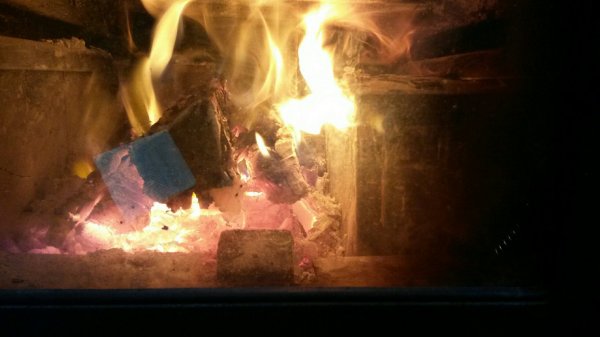

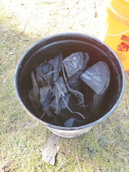

    Using the NC30 to make charcoal for the Kamado Joe. Small holes in the side near the top for breathing and removed the rubber gasket. Seemed viable on paper and works great in reality. Here she is in action. Flames blowing out as the Walnut gasses out. Since friday I have filled a 15 gallon tub. 20210308_065835.jpeg

    I am too frugal to buy charcoal when it is very easy to make. Perfect time to do in the shoulder season that is upon my area. Ammo box uses up about 1/4 of the firebox. I am working on getting another which would be real nice as it will provide a nice small pocket for the wood. Filled a second tub with all Walnut. Working on converting a Plum tree that was in need of being gone near my house. The smell in the basement where the stove is exactly what you smell when you go to a great wood-fired Italian restaurant.
