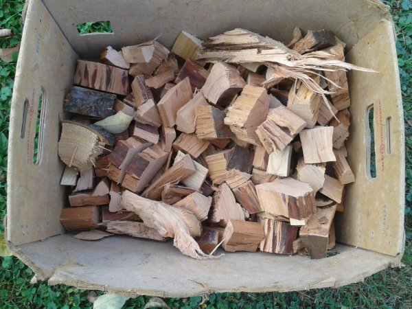

    I had a load of logs delivered last year by the farmer across the street. There were a few cherry logs and I did not want to send all that smoke up the chimney so I have been experimenting with making my own charcoal. I also had an old water pressure tank which I cut in half. Here is how I have done it:
    First I split and cut the split wood into little pieces

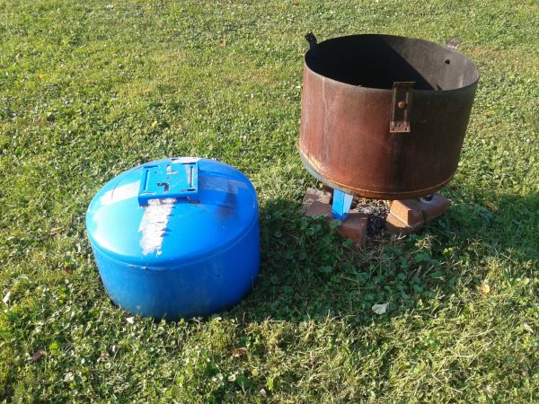

    Water pressure tank

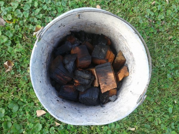

    Finished product
    So I get the wood burning then smother it with the lid and in 2 or 3 hours the charcoal is ready for my weber grill.

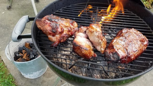

    Mostly cherry but also pear. I have a weber kettle so even though it is a grill if I shut the lid it works like a smoker. Made barbecue last weekend with pork and beef, slow cooked on the grill for 2+ hours, just kept adding a few pieces or charcoal at a time. Beef and Pork barbecue.jpg

    If I may give you some advice a bit more on your charcoal making technique and give you a couple things to think about. First, charcoal is purely carbon. It would be completely black. I see you still have unburned wood after you pulled it from the set up.
    No biggie but try again and get the fire REALLY going. Secondly, Start with a bunch of softwood as a fire, small small stuff, then add your cherry or any other hardwood chunks. Make sure those are going really well too. By the time it is probably going strong at 30-45 mins and all of your wood is on fire and some white ash is beginning to show on your wood , cover the fire. The softwoods will burn to ash but your charcoal wood will burn twice as long and really really slowly. Don’t be surprised if the fire goesn for a whole day, it should smoke quite a bit. Think about your grandma’s pressure cooker, had that steel cap that kept the steam going out slowly but not all the way? Same sort of measure here.
    What will happen inside is basically like a cigarette that’s left alone and burns slowly but not completely. The idea is to continue to keep the wood burning while limiting the oxygen to the fire. When this happens, you burn the gasses of Pyrolysis and done correctly, you’re left with this completely black almost shiny charcoal. I’ve done this with a small 25 gallon barrel with a lid of some kind. The trick is to really get it going hot before you take the lid to it.
    I’ve put this barrel in my previous pits, got a fire going under it and around it, piled up so much in hot coals around it that the wood inside was on fire because of the hot metal surrounding it. Before using the barrel, I had to burn off the paint from it and any other stuff inside it. Any paint on your charcoal retort is best to be burned off, you don’t want to get that paint to mix in what you’re going to cook with.
    Stuffing it with larger chunks of apple, oak, cherry, any fruit wood or bbq wood is good and the chunks being big really help too. if you make them too small, it becomes crumbly. Optimally your charcoal shrinks some 25 to 40% depending on how the wood is burned so if you start with a 3 inch wide split, you’ll end up with something that’s about 1 1/2 to 2 1/2 inches after the burn. Then What will be the indicator that it was done correctly is none or very few “wood” pieces exist. You should be able to take a chunk of the wood inside, break it in half and the two halves should reveal completely black charcoal all the way through. Also the weight of your charcoal to the weight compared of the wood you started off with will be about half. Big difference.

    Wow, glad I posted this since I have learned quite a lot here. I have not been putting the container in the fire pit just starting the fire right in the tank so the inside is completely black with no paint remaining. Originally I wanted to paint the tank up like a minion, but decided to try and make charcoal.
    I have been dealing with either the wood not completely becoming charcoal or I end up with nothing left just a nice fire. I suspect part of this it the seal on the apparatus I am using here (an old pressure tank). Even though I am replacing the top exactly where the tank was cut i still get a little bit of smoke, in fact I sometimes get smoke and flames coming out the bottom. Suspect I have to do something with closing my draft since the fire keeps burning. The charcoal does start really easy especially the wood part since it is so dry and since I am using a Weber kettle I can put the lid on and keep the fire down.
