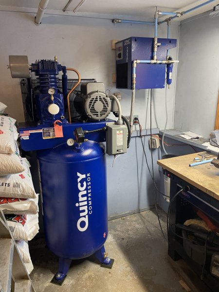

    You must have a big compressor? What kind is it?
    I just bought a Quincy 7.5 HP 80 gallon 2 stage reciprocating piston that weighs in @ 720 lbs.

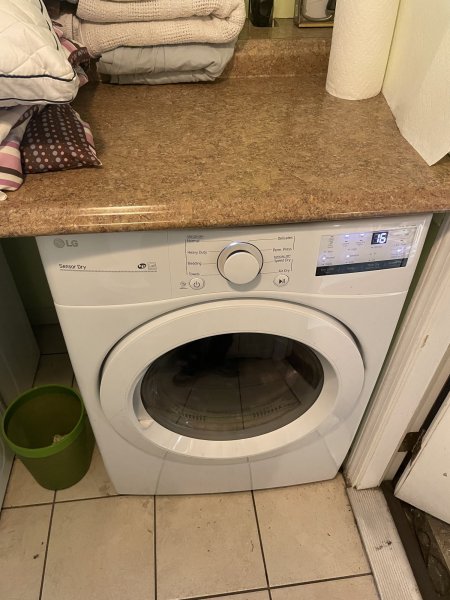

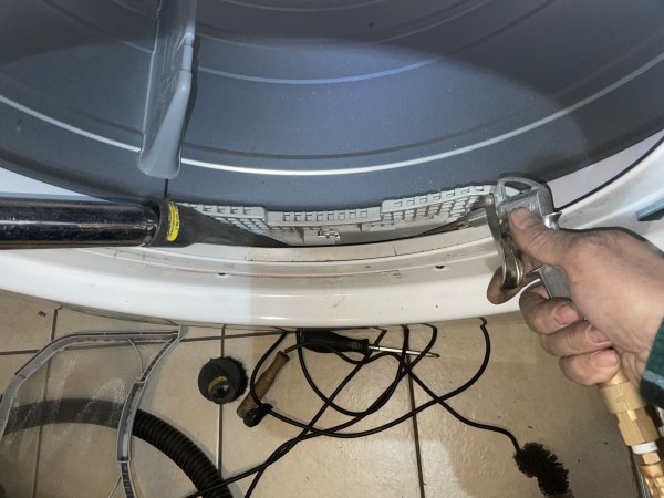

    Also on the Clothes dryer, even though we clean the lint screen, a compressor blow out in the screen compartment and sucking it up with a shop vac sure helps a lot too!

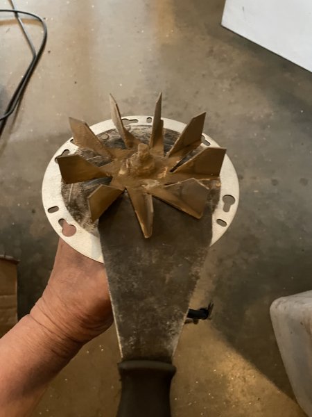

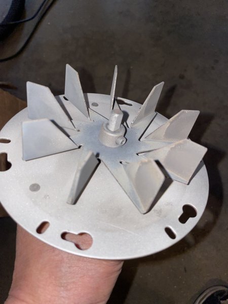

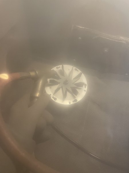

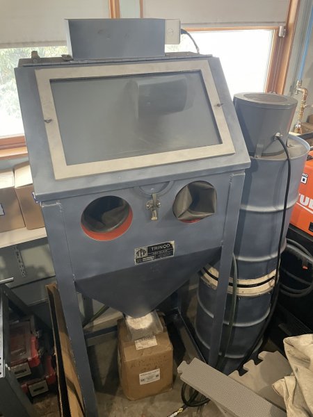

    Snowy
    Do you use your compressor on your pellet stoves?
    It can be an easy quick way to clean up those nasty old dirty exhaust blowers by using white aluminum oxide in a little blasting cabinet?
