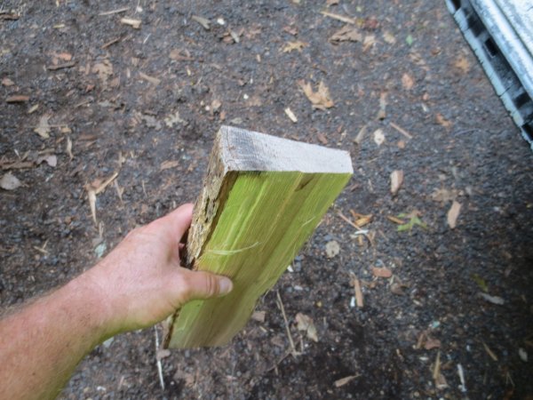

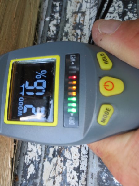

    When i first joined FHC i was skeptical about three years for oak seasoning. Had never heard of it nor the three year plan. The other day i checked 23 month old white oak splits and over 20%. Wood was SS October 2018. IMG_3032.JPG
    Halved split for checking moisture content. Average sized, maybe 4x4. IMG_3033.JPG
    Not taking that much oak anymore. Sad as i like processing it.

    Where did you get that meter & how many $$

    All we really get up here is red oak from the gypsy moths and luckily I have lots of room and crib stack all of my red oak. Stacking it this way has been a real difference maker for me. This past summer was fantastic for drying, had a constant breeze and many warm days with minimal humidity/dews. The neighbor had about 3-4 large red oaks cut in October last year, I split them into 16-18" toothpicks about 2-3" wide and here they are right now. My 2 year old stuff is in the 8-12% range. Had it recently rained or been wet? Stuff is a sponge and will fluctuate a lot in a couple days.
