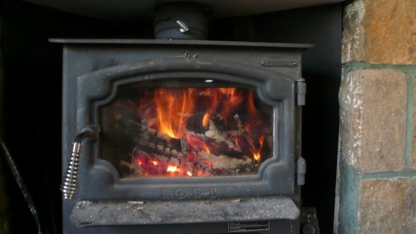

    I have the Lopi patriot basically the same stove, been burning in her for twenty years now.
    Had the same problem, with the no bypass damper, what I did was install a stove pipe damper right above the stove top.
    It seems to keep the flue gasses from just running up the pipe, keeping the stove top temps up around 600F.
    I set the air control to about 7/8 out (closed)
    Also helps me keep a long over night burn, and some nice secondary's.
    Once up to temp I set it about 3/4 closed as you see in the pic.

    Great information Chestnut, exactly the sort of stuff I was looking for. I've been contemplating the installation of a pipe damper and now I think I'll go ahead and do it. I've always had them on the other stoves I've owned but this one didn't have one when we moved here.

    I believe the two nock outs are for the blower install. With my setup I just have a blower in the back of the fireplace with a dimmer control for speed and a snap disc for on and off. I have about 15 feet of chimney with a crazy draft, with out the damper it seemed like the secondary's never stayed around long enough to light off. I guess every setups different hope it works on yours.

    Glad its working out for you Sam, it sounds like its acting the same way mine does.
    The only difference in our stoves I think, is mine doesn't have the outer sheet metal convection shell like the answer does.
    The thing that lead me to put in the damper was that when I would lookup at the chimney cap the heat waves were just boiling out.
    Hated to see all that heat just lost out the pipe.
    Since I put in the damper the heat waves are noticeably less than when it is wide open, and there's still no smoke.
    About the only down side is when I get enough build up to need to run a brush up there, I do have to pop out the damper, it is a small pain but she burns so clean its only every other year.
    I can get the gas burner jets if I run her up real hot before closing her up, they don't seem to last more than a few minutes before the regular secondary's kick in and they last for a few hours.
