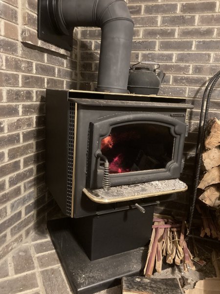

I just bought a house with a Lopi Answer that was probably put in in the later 90s. It doesn't seem to matter whether I have the damper lever on the bottom front is in our out. The tubes at the top of the firebox seem like they are in good condition. I am assuming that pulling it out dampers the stove.

I am assuming it is a non EPA stove. Unfortunately it will not keep a fire going all night long. Do newer ones do this?

The Answer (at least newer ones) are small stoves. True overnight burns are probably out of the question.

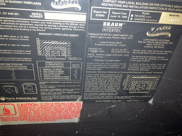

We have a Lopi Liberty (2008 or 09) when we pull the air control out, it will close the air down but not all the way because of the EPA standards. If you have a Lopi dealer near you, take the information off the back of the stove and bring it in and they can help you.
