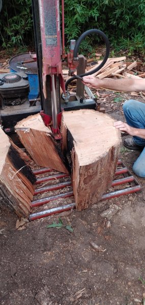

    Here are a couple ways we have made the process easier.

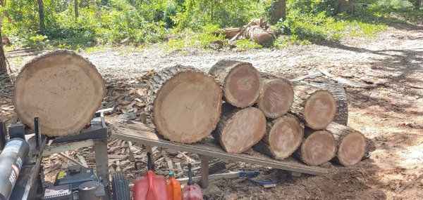

    For smaller rounds, up to about 28-30" dia, we use the horizontal position/new splitter. Made ramps w/braces, no lifting 0920211536.jpg

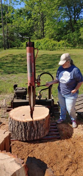

    Anything much bigger gets the vertical splitter. My wife spitting a 30"+ red oak

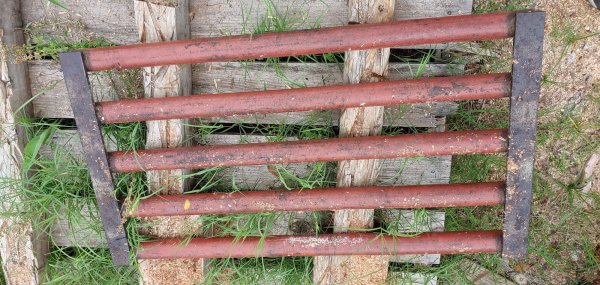

    To solve the problem about getting rounds of the splitter foot, we had a platform made from 2" angle iron and 1 1/2" pipe. 0720202018.jpg
    Roll a big round up to the platform, flip it over and slide it to the splitter.

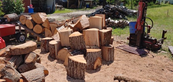

    Sometimes we put the 2 splitters close together, if we have a lot of big rounds to process. Break them down with the vertical and finish processing with the faster splitter. 0421201224_HDR.jpg
