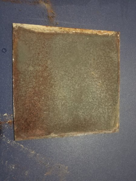

    20190930_173857.jpg I'm looking to clean the glass piece on the front of the woodstove or replace it. When I bought my house, one of the perks was the woodstove, but unfortunately the previous owners let the stove's glass get in poor shape. I'd say it was neglected maintenance-wise and they burned very wet wood for about 5 years.
    I've tried to burn it off by bringing the fire close to the glass. I've also tried spraying it with Easy-off, let it sit for a few minutes, and rinse it with water.
    This stuff doesn't seem to want to budge. Anyone have any tips or recommendations?

    Rutland's stove glass cleaner, or the tried and true wet rag dipped in wood ash.

    Razor blade scraper. New one will cut it right off. Follow up with some stove glass cleaner.

    All of the above mentioned methods are worth trying...but that window looks pretty roached...I bet even if you can get it where you can see through it, it will still look "frosted".
    If you decide to replace, try your local glass shop...if they carry pyroceram "glass" they can custom cut a piece for you...

    What kind of stove is it? I have a Vermont Castings Vigilant II which is meant to burn coal but it also succeeds at burning wood very well. Regardless how black and dirty the glass gets if I burn coal in it for 2 or 3 days the glass cleans right up. But you cannot put coal in a stove not designed for it. Coal burns at 3000 degrees and creosote cannot compare to that and it will melt cast iron, plate steel turns into a puddle. Try a few hot fires just do not over fire the stove nor over fire your chimney. If all else fails then buy a new piece but always keep the old just in case the clean one breaks, dirty glass is better than no glass.

    Steel wool and cleaner.
