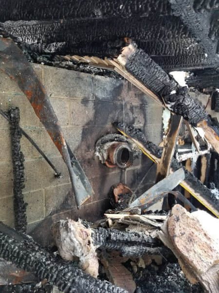

    Thanks, folks. We're rebuilding with a modular, so the opening size is kind of up in the air right now as we're in the design phase. The investigator was very thorough, and showed me what he thought happened. We had a block foundation with a lined block chimney. House was built in the late 90's. We moved in 4 years ago. There is a terra cotta liner in the chimney, and a thimble of the same material that comes through the block wall in the basement for the single wall pipe off the stove to go into. Previous to us, someone had studded out, insulated, and finished the basement. This enclosed the thimble in the wall. At some point, the botton third of the thimble cracked and fell in the wall, exposing the back of the sheetrock and the paper faced insulation in the wall to the single wall pipe. The fire was probably smoldering in the wall for hours before we were woken up by the detectors. We have burned 4-5 cords a year since we moved in, and have had the chimney professionally cleaned every fall. Below pic shows thimble, and smoke staining on the block wall behind the sheetrock. And my Hearthstone stove...

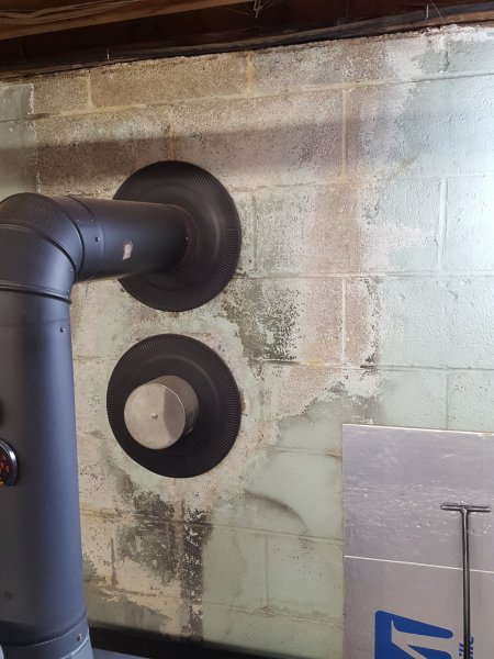

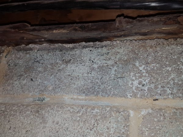

    And I understand your wife's reluctance to have another wood stove.
    I had a stain on the wall like that also behind my oil furnace (before the wood stove was installed.) And the sill plate on the top of the block wall is black.
    I found this after demo'ing my oil furnace out and removing the paneling. I believe it may have been caused by a clogged flue and the oil furnace.
    The oil furnace flue pipe was inserted into a "hole" in the block chimney. Then patched up with furnace cement.
    This is where my clean out is now for the wood stove. I had the rigid SS liner (professionally) installed for the new wood stove after installing a new oil furnace on the other side of the basement with a direct vent.
    I used a wire brush to remove most of the black stain
    Close up of the sill plate.
    I'm not sure if it is just stained from some water damage or black because it is charred

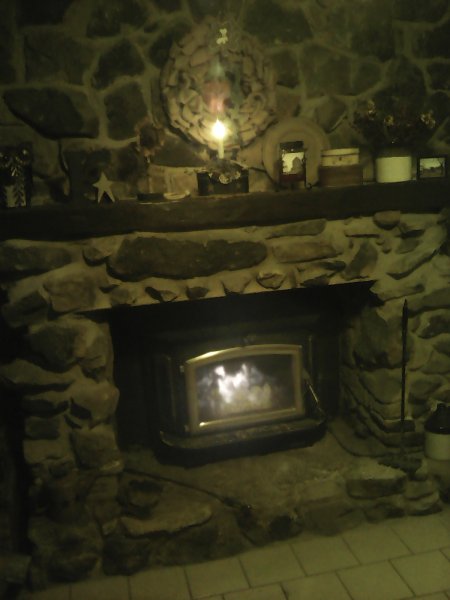

    Here is a shot of our Buck 91 insert.

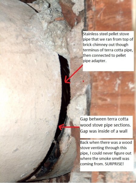

    Holy [email protected] can be replaced, life can not. My house was built by the most incompetent, cheap@$$ fool on the planet. I overlooked the terrible tape/spackle job, the tragic finish carpentry etc., but this one made me purple with rage. When I bought the house, there was a Fisher Grandma Bear woodstove in the rec room....they seller said that they used it to heat the whole house during the winter. Great, I thought. The problem with it was that every time I used it, there was an overpowering smoke smell....I checked every joint in the stove pipe, looked for cracks or broken welds in the stove itself etc and could not find the source. After a year of heating with the smoke dragon, I switched to a Harman pellet stove and part of the installation included running 4-inch flexible stainless pellet pipe down the chimney and through the terra cotta wall thimble. No smoke smell. After three years, my wife wanted to move the pellet stove to the corner of the rec room so I had to rip the sheetrock off the wall, demo the terra cotta pipe thimble, put new insulation in etc. Well well well, guess what I found? Yup, a 3/4" gap between the terra cotta pipe that leaked smoke inside the wall every time I used the woodstove. All it would have taken was one decent ember to fall through that gap and a fire would have resulted. How this passed inspection is beyond me. Enjoy.
