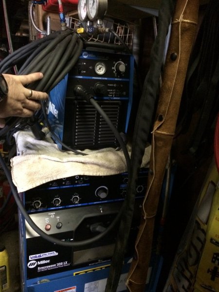

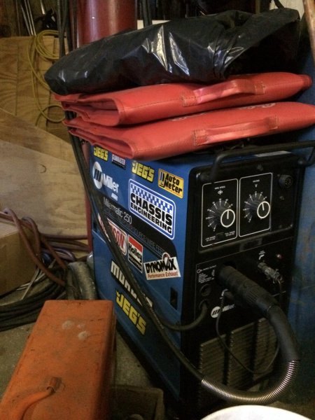

    Hey MM,
    Most transformer based Tig machines that use more than 4-5 amps at idle are using it for the capacitors from power factor correction. My Miller Synchrowave 350lx runs about 5 amps (240vac) at idle, and it was purchased without power factor correction. My buddies 350lx with power factor correction runs about 63 amps (240 vac) at idle. At full tilt, mine sucks down a whopping 135 amps while his only uses 85 amps. That capacitor bank really changes things !!
    The MM250 was the forerunner to the MM252
