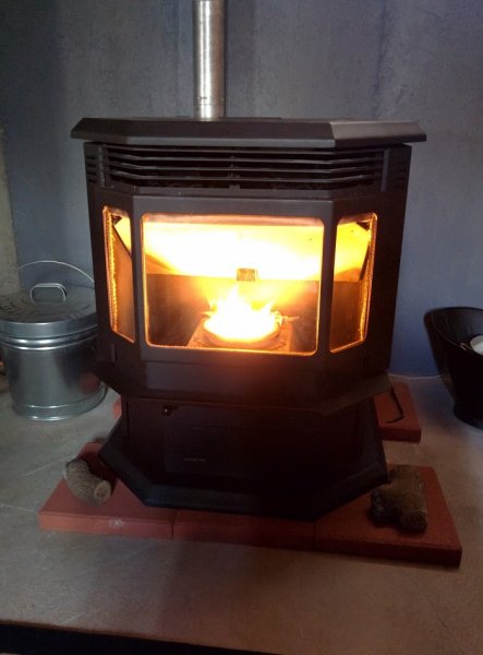

    Here is a photo from a customer who has just changed from wheat to crushed olive pits.
    THe photo shows the fire running at a temp of 1040 degrees F, just before it tripped out on over temp.
    I got the owner to dial down the fuel feed so the low fire temp was only 700 degrees which is still over the high temp for wheat. Wood pellets come in at about 1/2 between wheat and pits but as they are 4x the price they are not really an option.

    I would make sure nothing is laying around in the vicinity to have peace of mind when I go to bed, torch temps are HOT HOT:MM:

    Really getting with the program :D
    Not sure what the shells burn at, but a lot hotter than the pellets, as the #1 setting is just perfect and 2 is nearly too hot.

    I got my Quad up to about 800 and warped the heat exchanger tubes. I can no longer use the slider to clean them...
    What stove is that and where do you get olive pits? Must live in California.

    Nah I'm in Oz buddy.
    Thanks, its mine, see my website.

    1100° internal temps? Or external firebox temps?
    Internal doesn't seem out of the ordinary! But external? That's crazy!! What was it measured by?

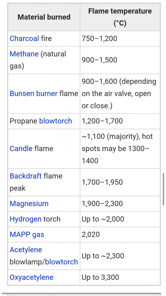

    Internal temps (of air?) that high wouldn't scare me.
    A candle can be about 2,600°
    Is this measuring a temp somewhere in or on the firebox wall? Because the flame in a pellet stove is much hotter than a candle when tuned properly and set at a high burn rate.
    Temps below are Celsius.

    Our older stoves, like the one in question, measure the flue gas temp at the top of the combustion chamber just before it goes done the heat exchanger channel, a good 2' from the firepot. Once the temperature is over 500 degrees C the exchanger can't extract enough heat and I reckon you would be heading for a meltdown hence the overload. Our newer stoves have the thermocouple in the exhaust just prior to exiting the stove. This took a bit of getting used to but is actually better as we can tune the exhaust temp accurately so we dont end up with condensation or waste heat out the back. It is also a good way to tell if the grain you are burning is any good; correct wheat exhaust temp varies between 80-110 deg C, some wheat struggles to get over 70. No heat and bad for the stove. Feed it to the chooks.
