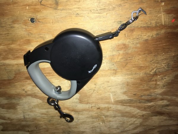

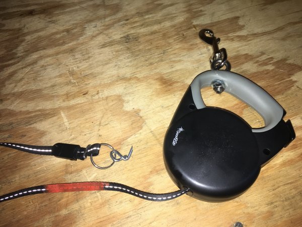

    Done! I painted the "tape" with bright orange paint in 2" long bands at 18" on center. Then I put an eye bolt thru the handle and put a clip on the eye that will attach to the loop on my wedge pouch, just like the spencer. I twisted and bent a Romex nail and attached it to the loop on the end of the tape that sticks into the log nicely. Super light, retracts very well, has a hard stop at the end so you can't pull it out too far and get it stuck. It's about 16' long so I got 10 marks on it. Works like a charm.

    Or maybe just good ole Red Neck logging! :D Paint is dry, tested today and works like a charm.

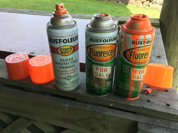

    I hate those markers with a passion! Spray paint, really? If I had one dollar for every FULL can of spray paint I have had to throw away over the years because it did not spray, I would be a millionaire! Yea sure, "When finished, turn can upside-down and spray until it comes out clear....". That works about 1 out of 10 times, usually it never comes out clear, or, it comes out clear and a month later you try to use it and NOTTA, it's all clogged anyway!
    There should be a law for every fuggin spray paint can to be makred CLEARLY: "ONE USE ONLY" ;)
    Coincidentally, the orange paint on my thumb Hookedup joked about came from a can of orange spray paint that did NOT work. I ended up making a puddle of paint with it, and painting the tape with my fingers (dipping into the puddle)…. which explains the paint all over my thumb. And of course all over the not pictured ruined bluejeans, T-shirt and gloves! ;)

    Here's what it took to get a few inches of tape painted from used orange "spray paint" cans.... LOL!
