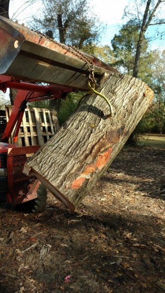

    I use a set like this for my trailer. Timbertuff. I’ll suggest if your using a bucket to lift you would be better off with tow sets of tongs. Hung by chains. Just one will have the log flopping up and down on the ends.
    Could swear my tong is a 28” model but all I see now in that size is spring loaded. Mine has no spring feature. MigHt not be a bad thinG if the springs stay on for more than a few days.
    I’ve modified mine to shorten the linkage as height is critical for my trailer. Removed the chain hook as that did t work for my application. Removed the d ring also. I use a screw pin shackle instead. Need to closely mimic the original d ring radius. A little smaller shackle works better with small logs.
    A sling hook can be used if proper radius to alleviate the shackle altogether.

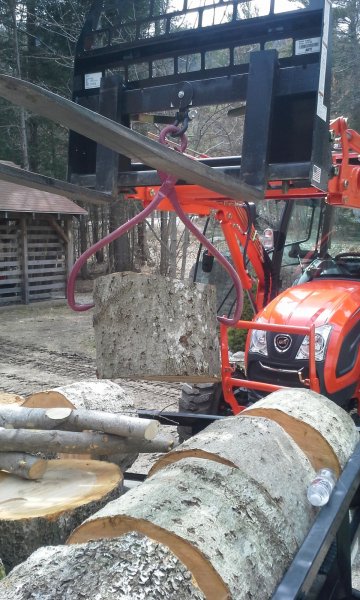

    Here is a pic of the tongs I've been using. No clue on brand, I got them from Backwoods Savage this spring. They work well for dragging logs. I don't often have a hook tender on job sites so I don't use them picking logs out of my stacks, too much on and off the tractor. I just use the forks. If you have two people they work well, just hook in the center & lift. I have no qualms cutting off the tongs. Just need to cut from each end or let the log tilt & undercut on the low side. 20210902_134326.jpg

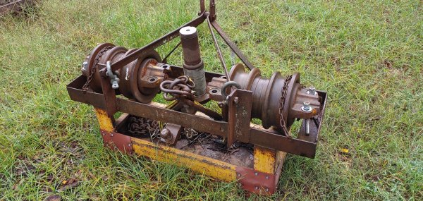

    No sir, that's the counterweight. Round things you see are undercarriage rollers from a D8 dozer. There are 2 of them on that frame, plus a big chunk of mill shaft. Weighs over 800#.

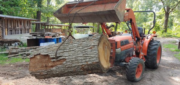

    If you're playing crisscross applesauce with that many loads & sizes it's a real pita for sure. It costs a ton of time trying to sort logs out. If you have a chain hook on the top of your bucket & a hook tender I'd bet the tongs will be faster. Short chain on the bucket & tongs & curl the bucket back to pick the logs, that'll help keep them away from the front of the tractor. I'd bet bet moving them one at a time & stacking neatly will save you time in the end. Get your hook tender a 3# hand sledge to set the tongs to avoid slippage & having to reset, that takes up time. Make sure to place your dead men/sleepers far enough apart to get between the easily with the tractor. I will the lay out 6-8 longer logs to cover the sleepers, then stack shorter on top. Rinse & repeat till you have them all stacked. If this costs a bit of time up front you'll more than make it back when you start taking the pile apart with forks. The smaller logs on top can be rolled onto the forks a few at a time by hand for processing, then you can easily fork the bigger ones without the jumble that makes using the forks more difficult. I hope this helps & makes some sense. Send pictures.:D

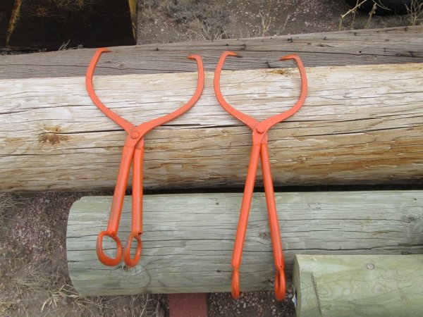

    This is a pair I made from some old ice tongs. They work very well and I have moved some pretty good size logs with them. I have maybe 25 dollars in them.
  16. Mag Craft
    Mag Craft
    Dec 15, 2014
    4,802
    27,713
    South East Wyoming
    I found another set of ice tongs later and made a second pair for use on wood. These are smaller which is great for the different size logs I deal with. They are very handy, I painted them orange so I would not lose them when up in the mountains.

    I took some better pics of the counterweight. It weighed 800# before I put that chunk of shaft on there. It was an old 3pt frame, short metal table that had been thrown in the trash and those rollers. Makes a great bumper when working in the woods 0917210845.jpg

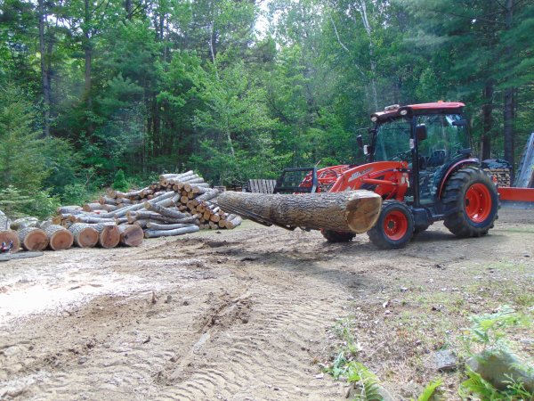

    I have a couple sets of log tongs (from Northern Tool) that I've used over the last 12+ years with no issues (mainly when winching logs out of the woods). I've played around with using the tongs for moving timber in the wood lot, but to me they are not practical (too time consuming). As others have said, you can do a lot with pallet forks, and I have moved and cut a lot of wood using that method. With that being said, you (OP) are correct in that forks aren't the greatest implement for picking up one log at a time from a jumbled pile. If you're investing in a new tractor and implements, and you are getting a large quantity of logs dropped off on a regular basis, I would strongly recommend investing in a grapple for your tractor. It is such a time saver and so versatile that I hardly use the forks anymore. (FYI, I have a DK4210 HST).
