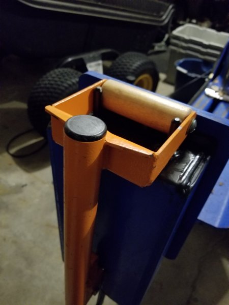

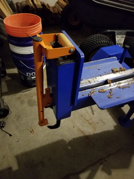

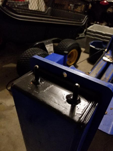

    Log Ox: Since I got it, I do not get the log splitter out without the Log Ox. In fact, I use it so much that I just got done welding a couple of pegs on my log splitter to hold it, so I don't have bend over to pick it up whenever I get a new round. I am thinking of ways to mount it on my trailer as well, so that I always have it with me with I'm cutting wood. The Log Ox is a bit situational... For lifting it grips anything between 4 and 15 inches. Bigger than that, and it will still grip for rolling and dragging, but not for lifting a round when my feet are the first thing the round will fall onto. (That's a guess on the lower end; I don't have any rounds to test with just now.) For splitting wood of that size, it completely removes the bending over to pick up any rounds. I also use it for gathering, pulling rounds into a pile to split later, loading them into the ATV trailer, and just wrangling them to cut. I no longer have to bend over to pick them up or roll them. What I can't pick up, I can generally drag with it, if it's under maybe 20", and it's super handy for dragging a round uphill, if I'm cutting in a ditch. For the smaller stuff, I pick it up and fling it, or pick it up and put it under my arm, allowing me to carry a couple of smaller pieces under one arm, and carrying another with the Log Ox. I also use it for moving logs before they are cut to rounds, either rolling them, or dragging what I can. I cut my rounds to 18", but if I'm getting wood from somewhere other than my property, I cut them to 36" because I can fit more in the pickup, and then cut them in half when I'm home. The Log Ox is handy for tipping up the 36" pieces on end, to get into the truck, or for dragging them to the truck. Sure beats rolling them to the trail.

    Belt Holder: This did not work for me. The Log Ox was just too heavy for my belts. Maybe if I did the suspender thing, it would work. I chose to weld the pegs on the log splitter instead.

    Welcome to the club.
    I did similar to what you did by making a hook on the log-tray for splitter and hang the log-ox there so as not to have to bend over.
    A little pricey but a nice tool to have.

    I think I’m going to put a couple of pegs also on my splitters to keep it off the ground.

    I used pegs, rather than just welding a piece of steel on, thinking that it would be easier to grab the Log Ox with gloves on. That idea seems to have worked out alright, because my gloved hand fits between the pegs. Basically, it was a trade off... A piece of steel cut to fit would be stronger, but less convenient for picking the tool back up. I'm not 100% sure that I won't break a peg someday, though.
    One change I would make if I did it over would be to try to bend the pegs in a bit. My pegs fit the Log Ox nearly perfectly, which holds it securely, but forces me to be precise when setting the Log Ox on them. If I had bent them in at maybe a 20-30 degree angle or so, I could hang the Log Ox with less precision, and the Log Ox would "ride" down the pegs if I was a little bit off. Not sure if that is a good way to put it, so let me try another way to phrase it. It would be the difference between hanging the Log Ox with my peripheral vision, vs. having to focus on that task for a second.
    Anyways, that's the next idea in the process for me, but not sure if I will re-do the pegs to get there.

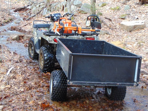

    I've had the forester kit for a couple years now. When I would go out scrounging, I brought chainsaws, a peavey, a timberjack, etc., and it seemed the LogOx would cut down on too many tools as well as saving my back from continuously bending over. I used it a lot when I first got it, and carried it with me both in the truck and on the ATV (as shown in the picture). I don't use it as much any more but it still comes in handy (I usually scrounge with just the saws, peavey and a pickaroon now). When my back is acting up though, it is nice to have and cuts down on constantly bending over. A friend with MS and a bad back purchased one after seeing mine and he swears by it.

    I like your scrounging rig.:yes:
    Cool to go out and cruise around and get a little work in at the same time.
