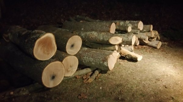

    Here's what he's brought over so far, an there's more to come! :thumbs:

    Delivered is good. Watch out, there is metal in one of that logs with the blue spot.

    Is there really? Is that what the stain is from? Thanks for the heads up, I will keep my eye out for it and hopefully my chain out of it! :)

    Yes. Blue stain means there is metal somewhere in the log along the line of the stain. Not all kinds of wood show it though. Being that it is near the center you might not be able to find a scar on the bark. The size of the stain on both ends might give you a clue also.

    be aware that one piece of metal can stain the tree 10 to 20 feet away

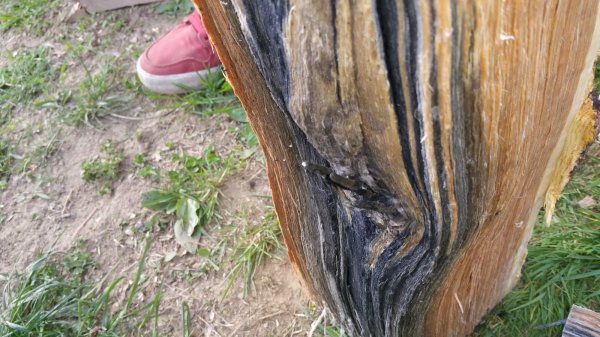

    Man you couldn't have been more right Paul! Started cutting the wood today and totally screwed my chain hitting a group of spikes in the middle of the log! I tried sharpening it but it didn't work too well, it's in pretty rough shape so I'm going to need a new chain.
