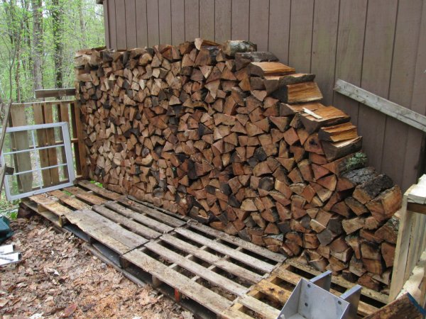

    As long as the wood is off the ground youre okay. IMO i would trim hedges back or keep stack shy of it and top cover. I have oak stacked behind my shed. Its on the North side and well shaded. The wood does dry, much slower than in an open airy spot. The end logs exposed to wind are noticeably drier when i unstack it. The spot works well for keeping the wood out of the way and out of sight.
    The stack of fresh splits from two weeks ago. It will be 3 rows and top covered when finished. 4'x5'x16' Stack is a couple inches off siding.
