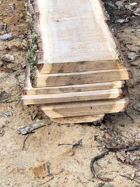

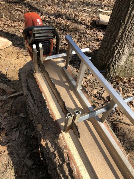

    Chainsaw milling is a very slow affair, especially oak and similar hardwoods. I say this from experience. If a band mill is in your future, just hold out and use that. And I see slabs all over the place for sale near me. Can’t imagine they sell like hot cakes.
