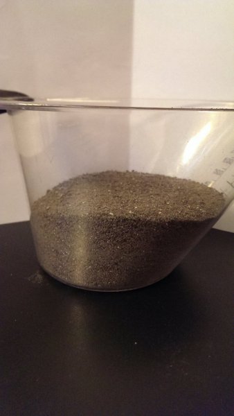

    Lignetics results: FINAL RESULTS
    Temp Average - 240-320 (on door thermometer)
    Ash Volume - 14 ounces
    Ash Weight - 2.30 ounces
    Ash Percentage - 0.38%
    Fines In Bag - less than 1/8 cup (was next to nothing)

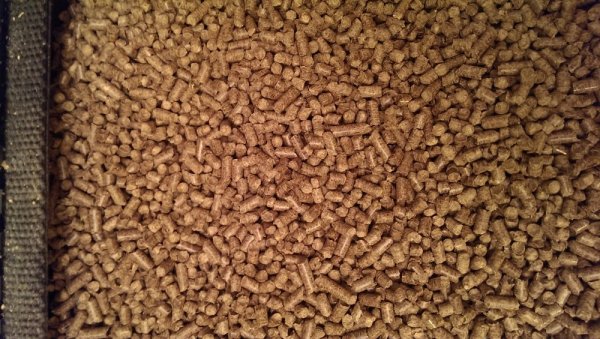

    Pellet Length Avg. - 1/4" - 3/4" see pic
    Bag Weight - 40.4 lbs. (2.85 lbs. left in hopper)
    Notes:
    Bought from Ace Hardware
    $225 a ton ($220 after my $5 coupon)
    DUSTY!!!
    High ash volume (fluffy and lots)
    Indoor storage at Ace.
    Overall...I bought this ton on a whim. I was driving by Ace one weekend and they were advertising these Ligs at $225 a ton so I pulled the trigger since they are very close to my house. First impression was the dust. I never complain about dusty pellets but these were the dustiest pellets I've seen in a long time. There also seemed to be a lot of fly ash too. These do burn well but purely based on ash volume, I probably wouldn't buy these again unless these were all I could get. I guess I must be somewhat of a "pellet snob" now.....

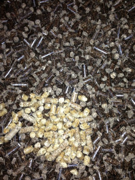

    Picked up a few bags of Liggies to try. Darkest pellets I have ever seen. Must be using coal dust as a binder!
    DexterDay likes this.
  16. slvrblkk
    slvrblkk
    6,638
    29,493
    Northampton, PA
    Holy crap.....looks like they are using black walnut or something!
  17. jtakeman
    11,732
    52,696
    They look like the PTL's I tested way back in 09'. Looks like Ligies still has the batch issues. The cream colored batch had nice heat and little ash. While these dark batches seemed to be full of ash. Still had nice heat though.
