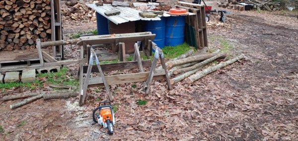

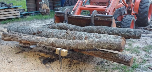

    I got my hunny the MS180, liked it better than MS170. I run it more than she does. A top handle would be nice, but it is light enough. Cut a lot of our smaller logs on the forks of the tractor and limb wood on the jig. 0819201949.jpg 0213200838.jpg 0213201023.jpg
  9. buZZsaw BRAD
    27,640
    164,795
    Wow! Are you bucking 16" all the time or is it mostly in tree? Been looking for a better rear handle to upgrade my 170. Passed on a lightly used rear handle 201 months back and kick myself for doing so.

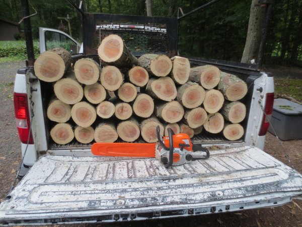

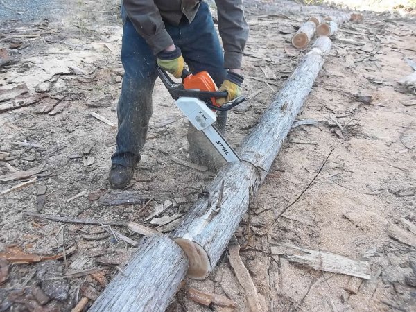

    Stihl had the 170 on sale in April so bought one. $170 out the door. I was skeptical as its a "homeowner" grade saw. Wanted a small saw for the same reason when cutting up an entire tree. Fast forward to August. TS Isaias hit. Few days later tornado hit as well. I PU some work from them (i sell wood and do some chain saw work). 170 put to work. Performed great. I love it for smalls and will buck up to 6" logs with it. Find myself using it more and more for the light weight factor. All this honey locust was bucked with it last week. IMG_3050.JPG IMG_3051.JPG
    I used it on most of the rest and bucked up to 8" I have all the limb wood home and will use it on them when the time comes. IMG_3047.JPG
    If money is not a problem id get a 201 rear handle with 16" bar. Keep in mind you will pay over $700 for it. Most of my other saws are pro models and wish id got the 201 instead. Looking for a decent used one. It was a saw i hadnt planned on using that often as most of my wood is scrounged as logs and not in "full tree" form. I own a Stihl 194 top handle which is handy as well.
