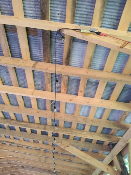

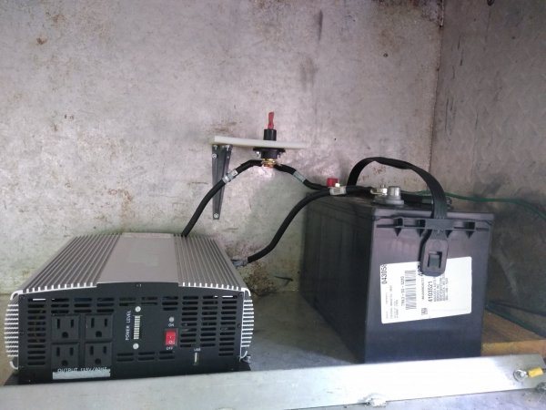

    Working on some lights for the mill. I wanted electric for lights and some tools. Decided on solar changing battery and a inverter. Went with a 3k watt. Should run anything I need to do.

    What kind of panels do you have set up? What regulates the battery charge? How many Amp-Hours is the battery rated for? Did you go with LED lighting to minimize the draw? Sounds like a cool setup..

    Champion 850 cca battery And harbor freight 100w solar kit

    Is it a starting battery, a deep cycle battery or combination? What’s the reserve capacity?

    deep cycle - unknown reserve capacity
