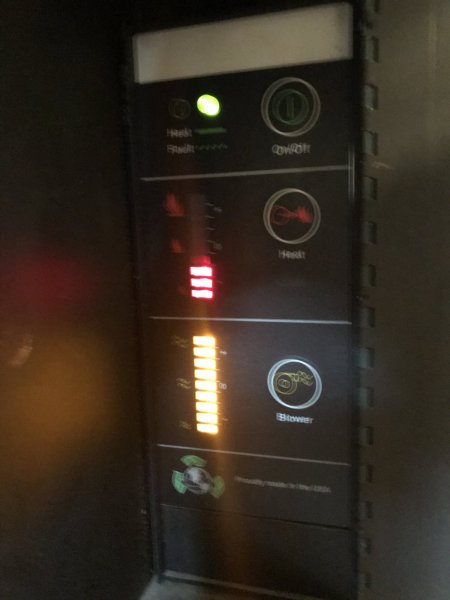

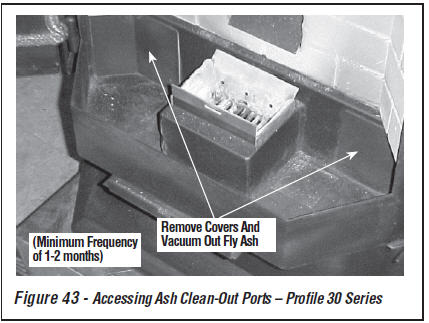

    The Profile 20 & 30 pellet stoves are like all the other Whitfields with the ash door slides that have to be pulled open to brush the ashes into the ash pan. Easier to just vacuum out and not even use the ash pan. See pic 1
    The Optima 2 & 3 pellet stoves are open so the ashes fall directly into the ash pan. This is a very desirable feature in my book. See pic 2
    The major difference between Profile & Optima pellet stoves. They both have the ash trap doors on the back fire wall.
    Pic 1 - Profile 20 & 30 with ash door sliders to ash pan which must be manually opened to brush the ash into the ash pan.
    Pic 2 - Optima 2 & 3 with large opening to ash pan so ash falls in ash pan automatically. :)

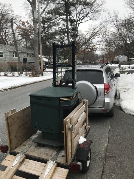

    Don...what's the size of your trailer?
    badbob likes this.
  9. don2222
    don2222
    Nov 10, 2013
    3,263
    4,422
    Salem NH
    It is a Harbor Freight approx 3’ x 4’ - works great! Why?
    1090 lb. Capacity 40-1/2 in x 48 in Utility Trailer
    Then I bought the pressure treated wood and vibration proof nylon stainless steel nuts and bolts and made a built-in ramp on a fold down back gate.
